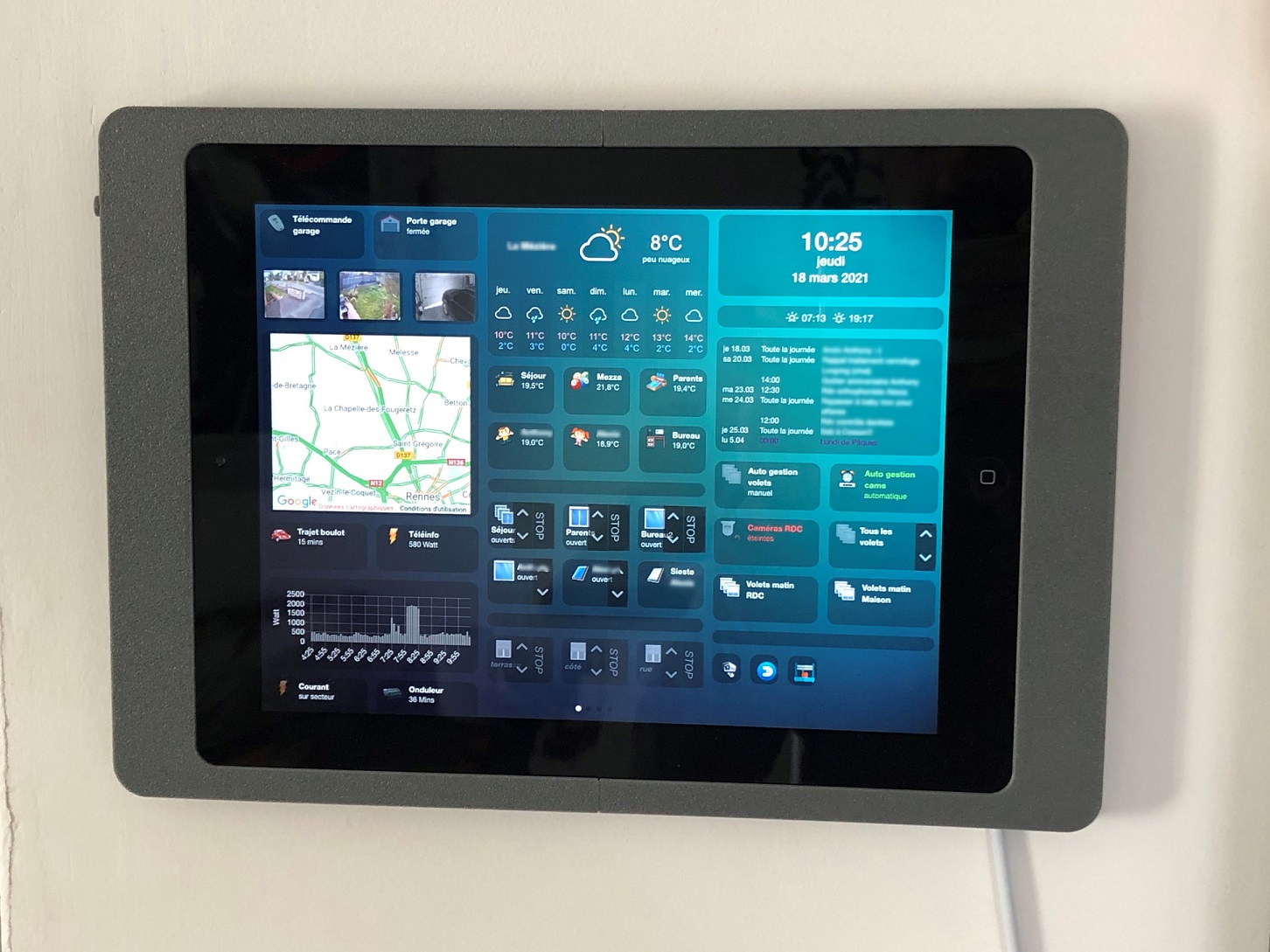

Hi guys,
After a long period to read the very complete tutorial and read you all, thank's a lot to the devs for their work! 8-)
I present you my board on my iPad 2, mounted on the wall with a support 3d printed ;)
MyDashticz on the wall (for forum).jpg (378.18 KiB) Viewed 3108 times
I use "Kiosk Browser for iPad" (better than a "shortcut of the dashticz page on the home page" which displays a useless bar with the battery)
But I still have a few questions that I summarized here: :)

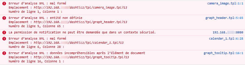

errors: I have a few errors with the dev tool, see the screenshot, what is wrong in my config? :arrow: just warnings
A few errors in DevTools of Firefox
Few errors.png (20.02 KiB) Viewed 3108 times

Thank you for those who will be able to help me for one or several points ;-)
Not really an issue. Your system tries to interprete the .tpl files as .xml files, but that doesn't work. You have this on firefox?

@HansieNL @Lokonli
I updated to the 3.7.6 beta, and it resolved some points ;-)
Points resolved:
4. long loading of device temp: I tried a new config with only 2 devices temp, and it was still slow. I recreated this buggy temp device, then it was as fast as the others, weird it was buggy between domoticz and dashticz?
7. hide a device: with the 1.3.6 beta, a css class to hide the button is now working with the functions in custom.js
8. calendar: I confirm the path /home/pi/dashticz/ical/agenda_personal.ics is now working with the 1.3.6 beta. But on my side it still takes a few sec to be displayed :(
Points to test again on my side:
1. auto exit of browser: i put it to 100000
3. secure dashticz
Points waiting for advice:
9. slow on iPad 2?
11. domoticz logs: how can I filter the displayed logs?
Points waiting for some checks on your side / points waiting for some improvments:
2. sleep screen
5. 6. cameras: if you want more details, either see my thread about it, or I can explain again
PS: first post updated.

1. auto exit of browser: i put it to 100000, but it still exit either from "afari as an app" or via "Kiosk Browser for iPad" :shock:
Other point:
11. For the logs: could it be possible to be able to select the log file we want? as an improvement? :P
