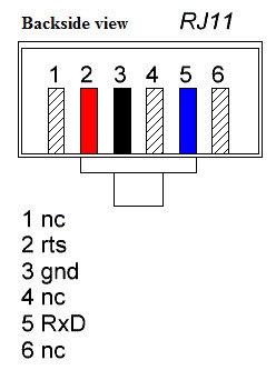

willem9136 wrote: Wednesday 17 March 2021 10:59 And an additional question, Is the Landis&Gyr E350 also having an inverted P1 output?
yes, inverted. you may need a 1k pullup between pin 2 and 5 at the meter, try without first.
17-03-2021 11-16-48.jpg (19.58 KiB) Viewed 498 times
