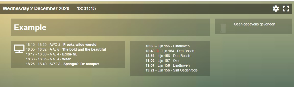

Hi Lokonli,
I downloaded the latest beta (I'm running it on a Synology NAS), no luck.
See config and picture for the output.

The output :
Any ideas?
Tia Johnnie
Raspi 3B+; Razberry zwave; zigbee; lots and lots of sensors
Lokonli
Posts: 2292
Re: Garbage collector deafvalapp doesn't work anymore
Post by Lokonli »
johnnie wrote: Wednesday 02 December 2020 18:34 Hi Lokonli,
The output :garbage_beta_deafvalapp.jpg
Any ideas?
Tia Johnnie
I tried the afvalkalender gemeente Zalbommel:
https://www.afvalinfo.nl/afvalkalender/ ... zaltbommel
Also there your zipcode doesn't work.
So it seems that for your zipcode the afvalapp doesn't work at the moment.
If you can find a working website where you can retrieve your garbage collection data then let me know.
Lokonli
