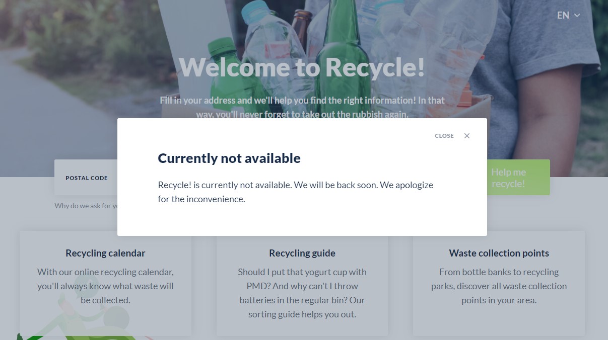

Lokonli
Posts: 2296
Re: Dashticz - Module - Garbage collector
Post by Lokonli »
It seems recycleapp.be doesn't work at the moment:
(and you are right on your remark on line 999. Thanks! but not related to this issue)

The recycleapp website is working again after being down for some days. However the dashticz garbage doesn't get any data on 3.6.0 and 3.6.2 beta.
Probably the API that's still down...
