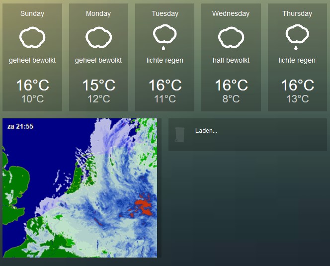

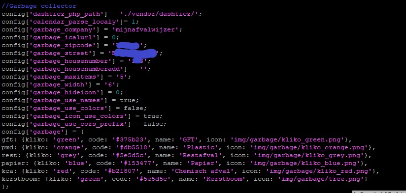

Re: Dashticz - Module - Garbage collector
My garbage collector has stopped working. It only mentions loading. I have no idea why.
Someone who has an idea how to get it working again?
See attachments for more info.
- a1.jpg (67.87 KiB) Viewed 2296 times
- a2.jpg (80.59 KiB) Viewed 2296 times
Lokonli
- Posts: 2296
Did you already try Dashticz 3.6?herbod wrote: Saturday 26 September 2020 21:51 My garbage collector has stopped working. It only mentions loading. I have no idea why.
Afvalwijzer changed it's interface a few weeks ago. A fix has been implemented already.
If it's not working, please send me your zipcode and housenumber (you can do that by PM) and I'll test.
Thanks for the tip. I have updated to 3.6 but the problem remains.
My zip is **** and housenumber *** (unfortunatly I can''t send PM)

Lokonli
- Posts: 2296
You have to remove the setting config['garbage_use_cors_prefix'] or set it to true.herbod wrote: Sunday 27 September 2020 7:36 Thanks for the tip. I have updated to 3.6 but the problem remains.
My zip is 7004LA and housenumber 133 (unfortunatly I can''t send PM)
You also must have PHP enabled.
Garbage for your address is working on my system.

herbod
- Posts: 8
- Joined: Wednesday 22 January 2020 22:20
Thank you! it is working again. I have sett ['garbage_use_cors_prefix'] to true but wat does it do? I am trying to understand what i did.
