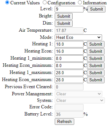

I've added a Eurotronics Spritz z-wave thermostat. From the ozw panel I can see the thermostat reports the actual temperature. However domoticz created a lot of devices temperature is not one of them.
Is there a way to get a device for the temperature?
OZW Panel
OZW Panel

What Domoticz version and ZWave version are you on, because I have another screen.
Currently I have 10 devices created.

All Zwave devices should be auto-created by Domoticz. How else should the Zwave system know which device to update.
It might take some time for every device to be created, even up to a day.
On beta version 12501 it should look like this.
But the best way to help you is by knowing which version you are using. ;)

You were right, eventually the temperature device showed up. Probably triggered by a change of temperature large enough to sent a message out.
