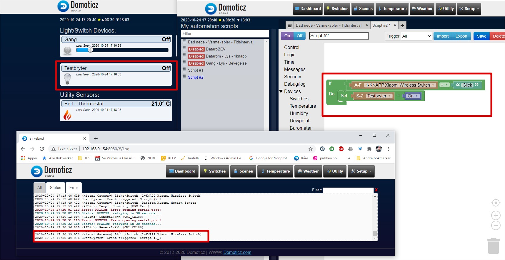

I have a Xiaomi wireless switch and a dummy switch. (I've made it this simple to exclude as many other factors as possible).
When i click the button it appears in the log as "EventSystem: Event triggered <name of script>_1 but nothing happens.
What am i doing wrong here?

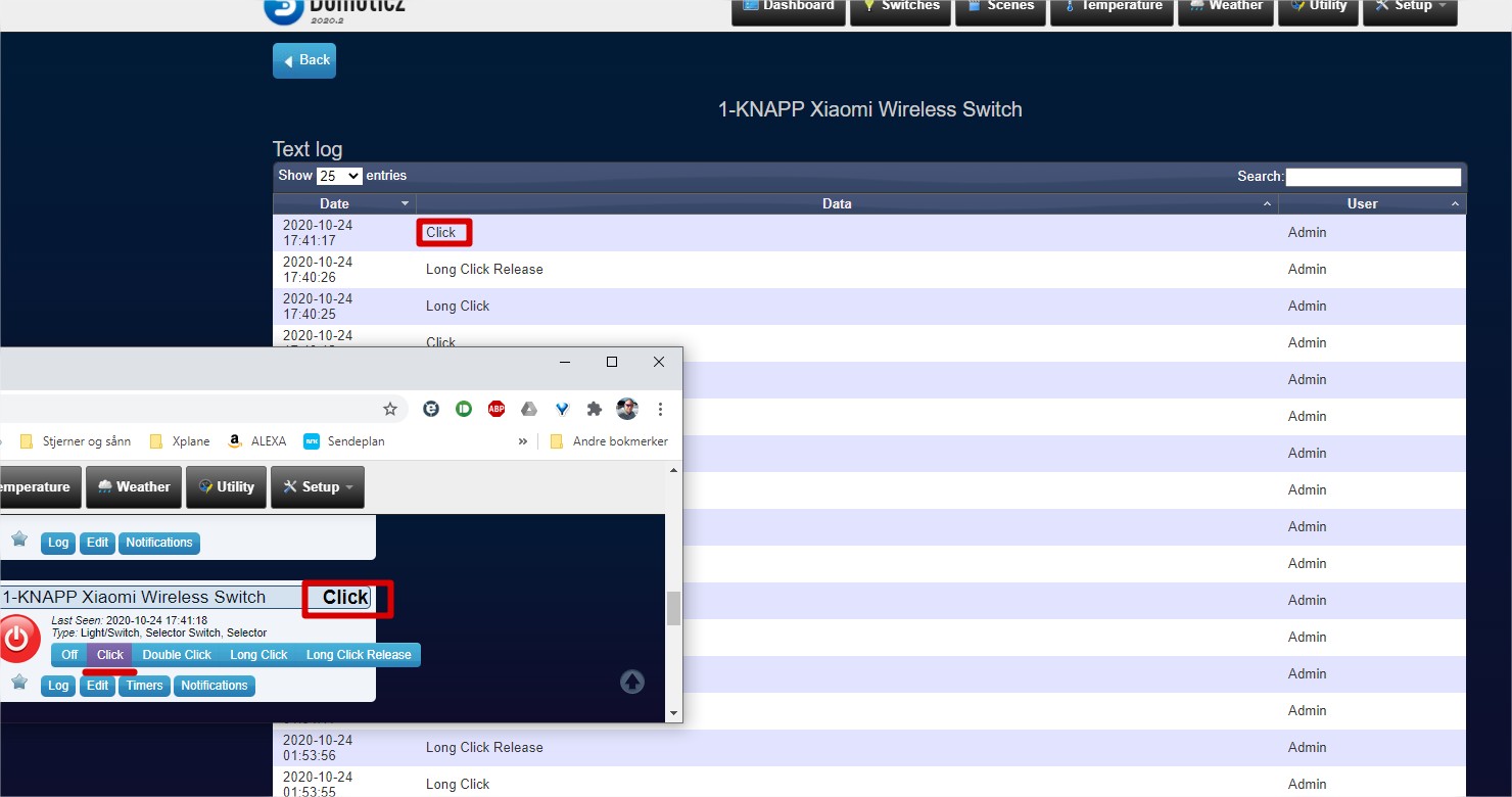

Are you sure you should test for "Click" in stead of "On"?
What does the log for that switch tell you?

Re: Blocky triggered but not activated?
Thx for reply
The log is saying "Click", "Double Click" and so on. On my old server (version 4.10717) it is working fine with the same script.
Maybe you need to test the LEVEL sinds this seems to be a Selector switch.
Off = 0%; Click =10% ; etc.

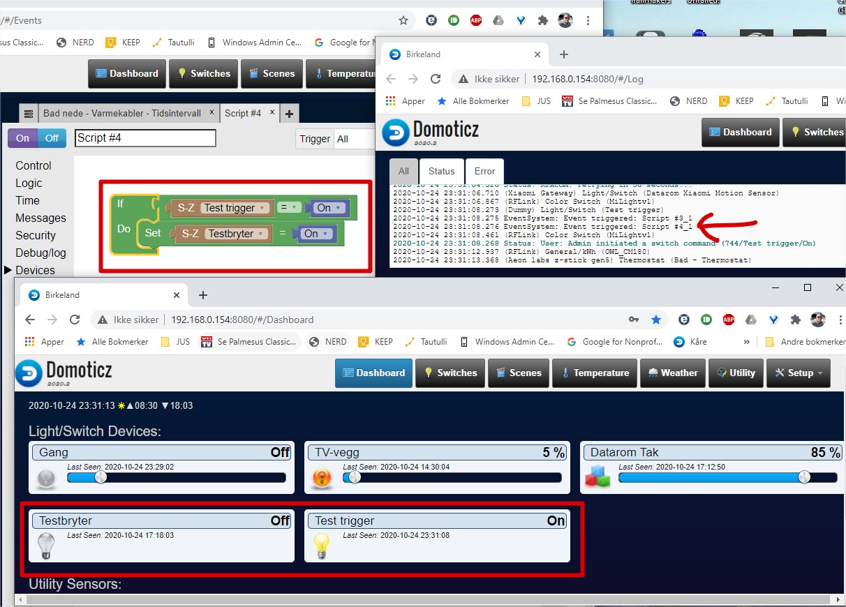

I created a virtual trigger switch so i ended with 2 dummy-switches.
Still same result.
It cannot get it any more basic than this so what happens when i am to include more than 2 switches
Still same result.

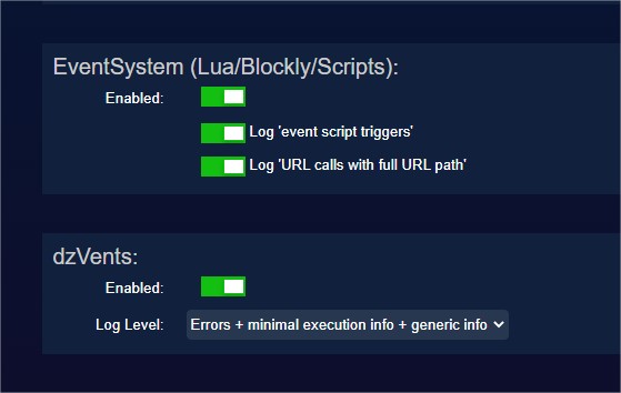

No blocky scripts have ever worked. I tried to disable then re-enable "EventSystem" but no changes
- eventsytem active.jpg (25.76 KiB) Viewed 1136 times
