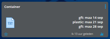

I managed to make a dummy and created a data file (made from another zip code) and alter it to my garbage service dates. 👍🏻

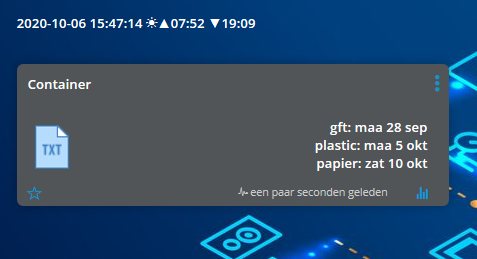

Hi jvdz, i have a issue with the m_csv_file module. It is showing two old notifications. i just enable debugging to create a log, normally the script updates 2:30.

jvdz
Posts: 2441
Domoticz version: 4.107
Re: GarbageCalendar (new version) lua scripts
Post by jvdz »
I see a couple of strange things in the log that I don't understand, so could you Email me the following files in a zip file, so I can have a closer look? :
  • Garbagecalendarconfig.lua
  • Your input datafile with the csv dates as defined in the config.
  • /var/tmp/garbagecalendar_m_csv_file.data
  • /var/tmp/garbage_run_m_csv_file.log
  • /var/tmp/garbage_run_update_m_csv_file.log
  • /var/tmp/garbage_web_m_csv_file.log
.. but it feels like something is going wrong in the nightly run. This info is located in the garbage_web_m_csv_file.log.
Thanks, Jos
