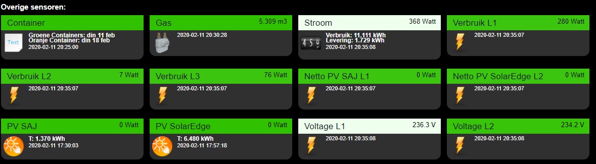

Posts: 412
Domoticz version: 2024.3
Location: east netherlands
Re: GarbageCalendar (new version) lua scripts
Post by BarryT »
jvdz wrote: Tuesday 11 February 2020 21:17 Thanks for testing Barry, but I have a different result for your info than I see in your image:
@GarbageCal(m_mijnafvalwijzer): ==> found schedule:
Oranje Container met Plastic en Metalen: Din 11 feb ;
Groene Container met Tuinafval: Don 13 feb ;
Oranje Container met Plastic en Metalen: Din 18 feb ;
... or am I missing something? :)
Jos
No problem!
I changed the text, i like it small, but the garbages are correct with our postal.
Today it where the green ones since we have a big garden we have 2 green ones, 1 orange, 1 blue and 1 gray garbage. It depends on postal, 10km from here it was orange, in here it was green ;)
