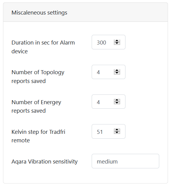

I've paired an Aqara vibration sensor to my Zigate but how can I adjust the sensitivity?

You need to set the paramter through the Zigate web admin page which should be available at http://yourIP:9440/
Go to "Settings" and you should get the following:
Documentation is available : https://github.com/pipiche38/Domoticz-Z ... nf.json.md
You can set the sensitivity to low, medium, high

Damn... Missed that one! Thanks!
