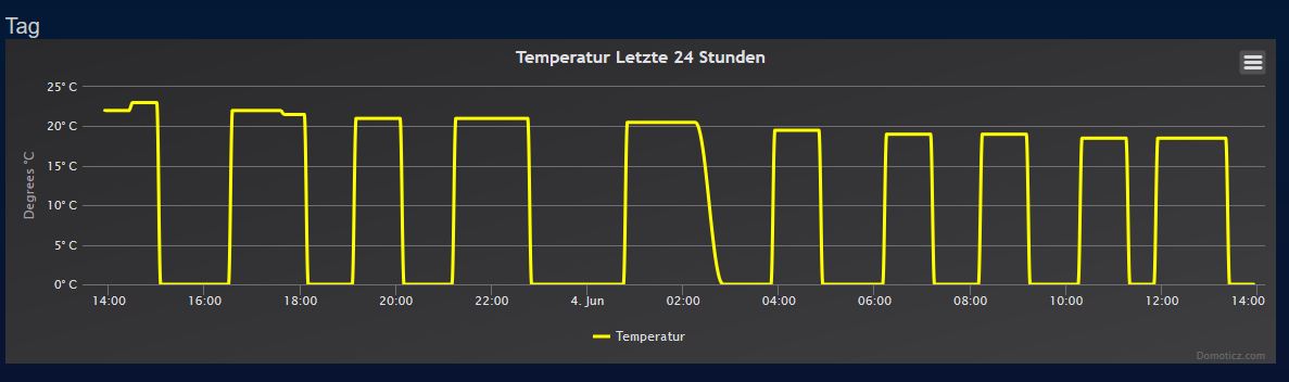

Ok, than it is perhaps a problem of my sensors!?
Attached my temperatur. Inside it's the same. And in this case I see also 0° in my display :-(.
But more important would be a control of the current. But it's a problem of the API - I know!

I guess there is indeed something with either you API-connection or the sensors. Is is the chart for the charge level OK?
You could also check this to see what e.g. TeslaFi is reporting.
Below is my chart:

The chargingchart seems to be ok.
22:10 47%
8:10 46%
still than 45%
Normally the Tesla should sleep, so I'm wondering about the values, but perhaps Tesla waked it up!? In the graph for the month, I see a continue loss of 2% every day I don't use the car. Using&charging the car will also be fine.

If you can provide a graph of two days together with the table of the status of those same two days, we can see if it happens during sleep. With your current time settings, domoticz should not wake up the car. But I’ve only tested with a model 3, maybe you have a different model that behaves differently.

How can I make a graph of 2 days? In domoticz there is no option for this. And no statustable for temperature. (Only for switches)!? (I have Model S)

The Tesla hardware has a status device, that indicates if the car is away, home, charging etc. That one has a table. We can match that with the graph.

ok, I have seen that. Data as attachment.

The 0’s are very strange. I will check the code if there is any situation where a 0 could be filled without retrieving data from the Tesla.
I do notice that your car is hardly asleep, even at night. The car often wakes up by itself. My guess is that you have sentry mode on at home, along a busy street. That may explain the battery drain...

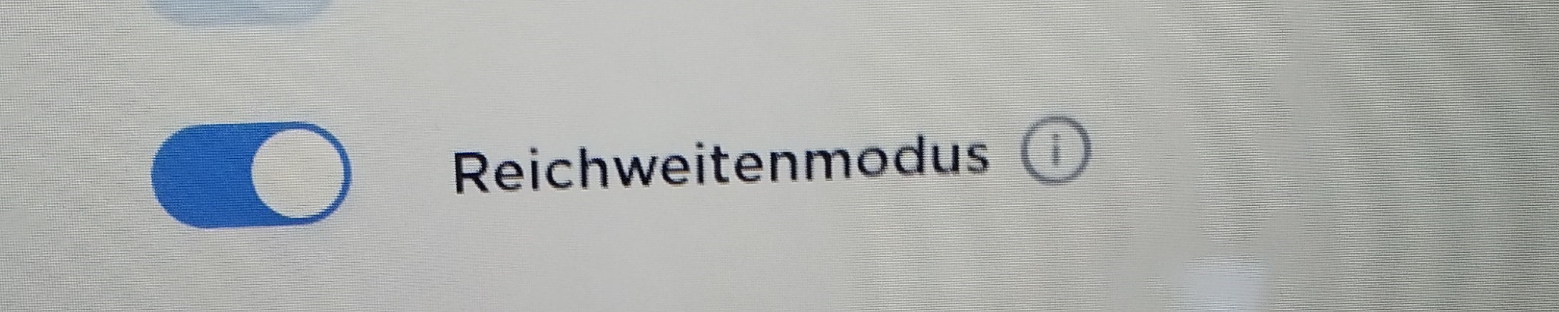

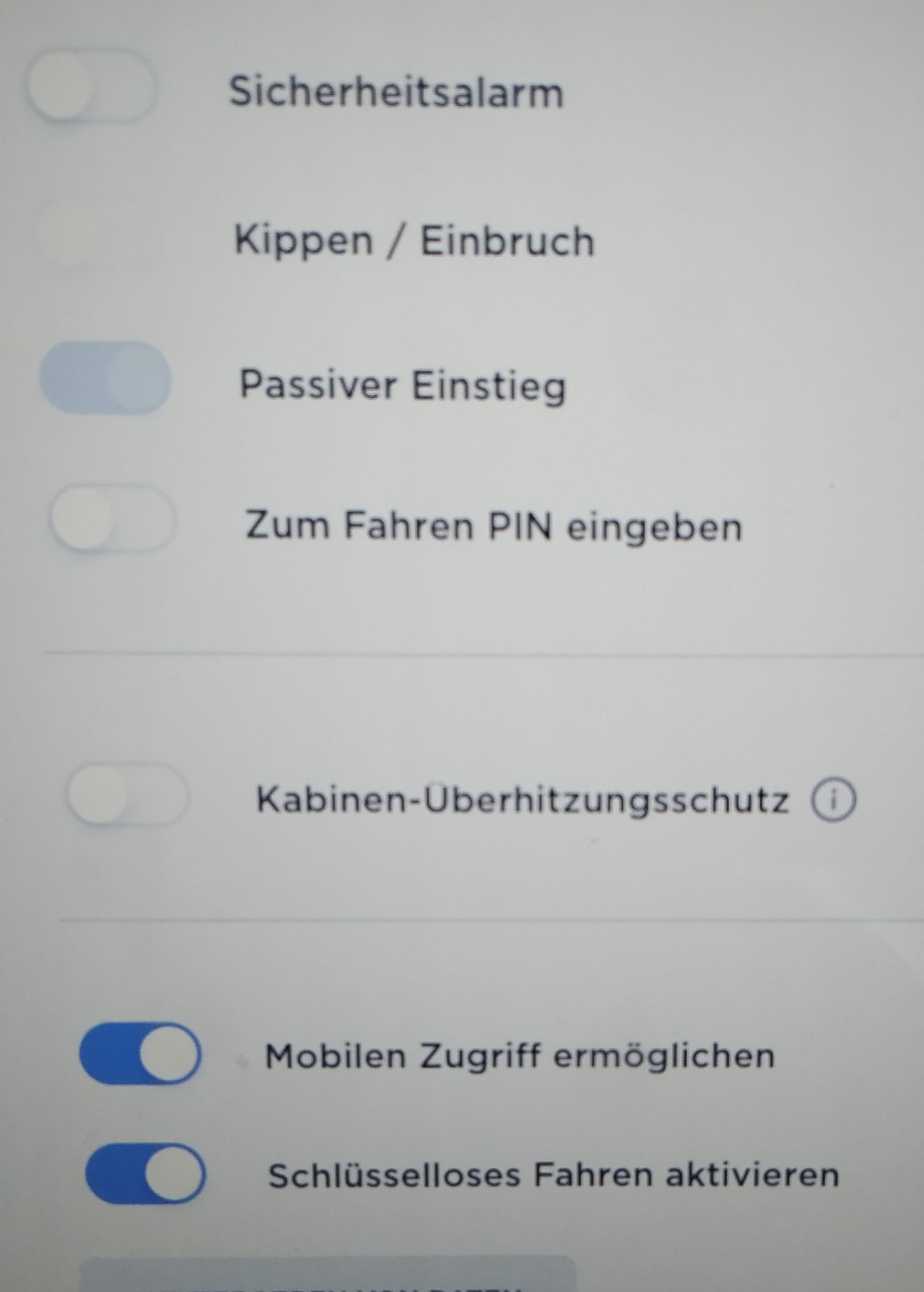

Thanks, for lookin in your code and the hint. The battery drain is very bad of course. I wondered also, but cannot find a reason. Alwayss 2% per day. I think it is a lot. The graph for last 24h shows:
09:15 51%
17:30 50%
04:25 49%
I thought, I used all battery savings but without Mobile access. I think I switched it off for test, but is was not better. And I'm not living at a busy street. I live rural with very less traffic. Any hint for battary saving appreciated!
