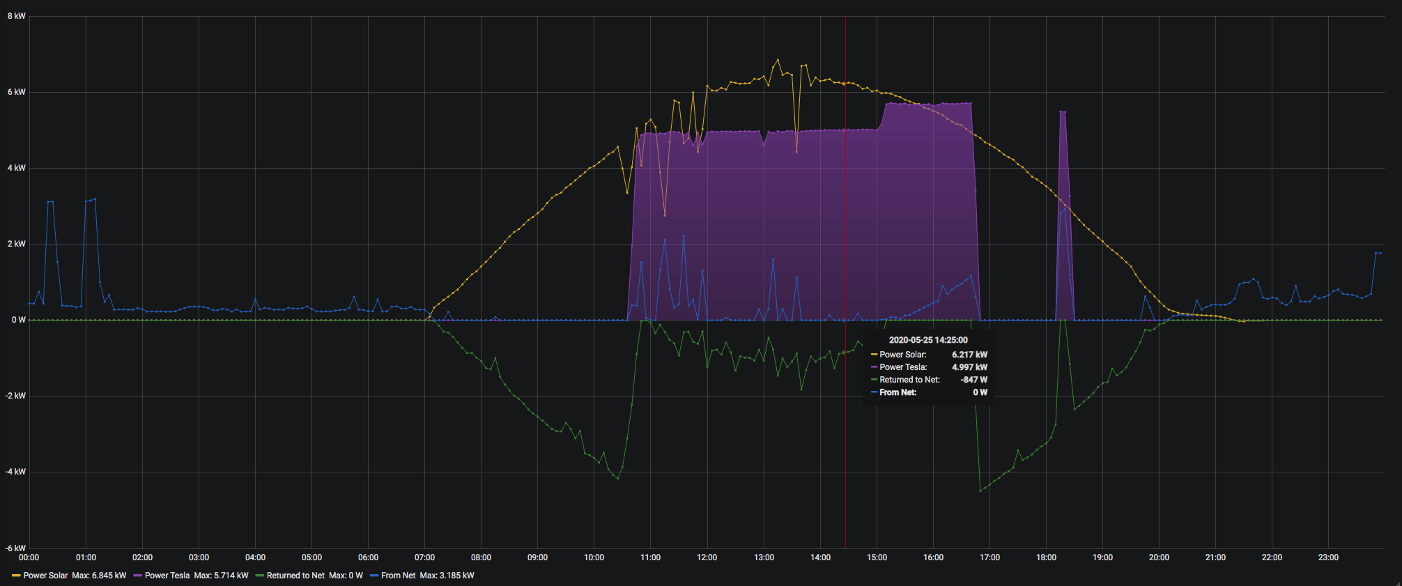

That is actually exactly what I have done.
I'm not so good in DzVents so I used NodeRed to provide the logic and read the Tesla status from Domoticz (using MQTT) and the info from the Solar panels to decide when to start and stop charging. I also included a virtual "TrackSolar" switch in Domoticz to indicate if charging has to be done by the script or is on "manual".
To be able to this, of course you need real-time data from you solar panels.
I am using a Modbus Kwh meter on the Solar panels and a script to read the Modbus data for this. The data is then posted on a MQTT-topic where this can be picked up by the NodeRed script. You could perhaps also use the API of you Solar panel suplier like SolarEdge if this real-time enough.
Only thing on my wish list is to be able to dynamically change the Amps. I now manually have set it in the car at (3 x) 6 or 7 Amps which is still 5-6 Kwh.
See below,the purple line is the charging power to the car, it is activated if the Solar power exceeds 5Kw during 2 minutes and stopped if it is less then 3 Kwh during 5 minutes or the car is full (in this case).

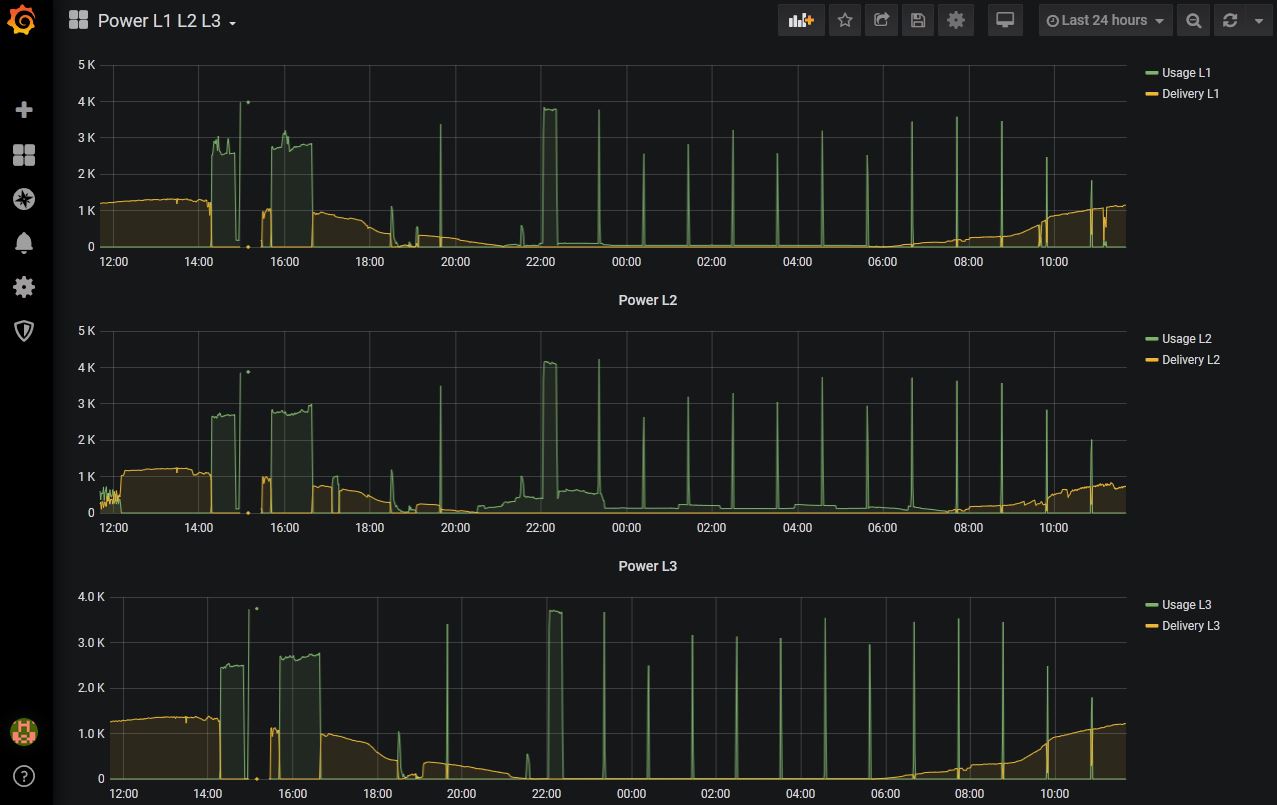

Guys,
I do not want to hijack this topic, just a quick Q.
Do you see the nightly spikes as well? Any clue why this is "good" ?

Post by Bikey »
Nope, I can see a steady current of 0,03 - 0,04 Amp on 1 phase to feed the TWC itself, but that's it.
I have to say however that I only read my Modbus meter only once per minute, so if it are very short spikes I might mis them.
I think however that this is an indication that your car isn't sleeping well and wakes up about every hour. So perhaps you have set your polling interval incorrectly or another App that wakes it up.
I'm using TeslaFi which says my car sleeps all night.
