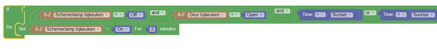

I have a blockly using 2 conditions:
- a switch condition
- a time condition.
- trigger on switch (not all to avoid too many checks)
If switch is on and time > 22:00 the action should start
This event does not trigger. Can't figure out why

Are you sure that deur bijkeuken is open is the right trigger? Should it not be On of Off?

It's good to check the right state indeed. Next to that you're time locks should be with an and I guess. Because now one of them is always true.

@Wouterlet, Time can never be > then Sunset And < then Sunrise. That will never happen. Because > sunset is from sunset till 0:00 and before sunset is from 0;00 till sunrise. If I'm not mistaken. So OR is okay here.

I'm sorry you're right. I switched them around. That part must be fine
