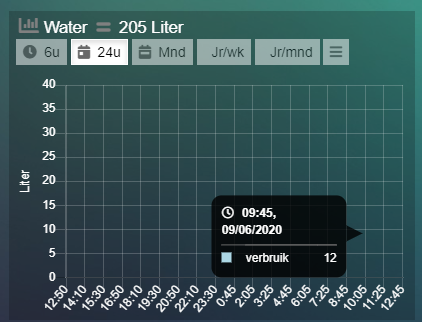

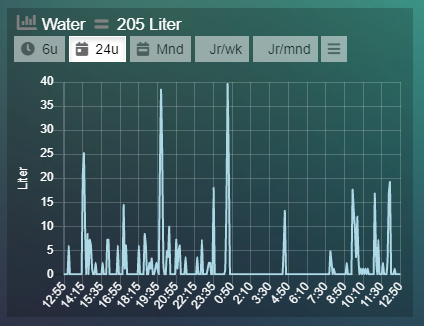

I have a strange issue with my water meter graph.
I have different views, 6h, 24h and also month, week etc.
The 24h view doesn't show the bars, the tooltip shows a value. But when I change the graph to line, the line is visible.
The 6h view also behaves strange. The bars are visible, but when a new day starts, the bars dissapears. After 6AM in the morning, they appear again.
Output from the debug button:

Jimster wrote: Tuesday 09 June 2020 13:06 Output from the debug button:
	"ActTime" : 1591700828,
	"AstrTwilightEnd" : "00:00",
	"AstrTwilightStart" : "00:00",
	"CivTwilightEnd" : "22:46",
	"CivTwilightStart" : "04:36",
	"DayLength" : "16:35",
	"NautTwilightEnd" : "23:59",
	"NautTwilightStart" : "03:22",
	"ServerTime" : "2020-06-09 13:07:08",
	"SunAtSouth" : "13:41",
	"Sunrise" : "05:23",
	"Sunset" : "21:58",
	"app_version" : "2020.2",
	"result" :
			"AddjMulti" : 1.0,
			"AddjMulti2" : 1.0,
			"AddjValue" : 0.0,
			"AddjValue2" : 0.0,
			"BatteryLevel" : 255,
			"Counter" : "1416.612 m3",
			"CounterToday" : "227 Liter",
			"CustomImage" : 0,
			"Data" : "1416.612 m3",
			"Description" : "",
			"Favorite" : 0,
			"HardwareID" : 29,
			"HardwareName" : "Unknown?",
			"HardwareType" : "Unknown?",
			"HardwareTypeVal" : 0,
			"HaveTimeout" : false,
			"ID" : "140CE",
			"LastUpdate" : "2020-06-09 13:05:55",
			"Name" : "Waterverbruik",
			"Notifications" : "false",
			"PlanID" : "0",
			"PlanIDs" :
				0
			"Protected" : false,
			"ShowNotifications" : true,
			"SignalLevel" : "-",
			"SubType" : "RFXMeter counter",
			"SwitchTypeVal" : 2,
			"Timers" : "false",
			"Type" : "RFXMeter",
			"TypeImg" : "counter",
			"Unit" : 1,
			"Used" : 1,
			"ValueQuantity" : "",
			"ValueUnits" : "",
			"XOffset" : "0",
			"YOffset" : "0",
			"idx" : "126"
	"status" : "OK",
	"title" : "Devices"
Thats not the debugButton. See here: https://www.domoticz.com/forum/viewtopi ... on#p237106

Jimster wrote: Tuesday 09 June 2020 13:06 The 24h view doesn't show the bars, the tooltip shows a value. But when I change the graph to line, the line is visible.
Hi Jimster, apologies for the delay in responding - things have been manic at work. I have created a dummy water meter (RFX meter) and added your block. I cannot replicate this. The graph correctly displays bars for each range.

clinkadink wrote: Saturday 20 June 2020 9:37
Hi clickadink, as far as I remember, it worked the first day. Can you check if it still works for you the next days?

Jimster wrote: Sunday 21 June 2020 13:01 Hi clickadink, as far as I remember, it worked the first day. Can you check if it still works for you the next days?
Yes, it still shows the same graph today, same as above. But don't forget, I am using a dummy device, with no data.
