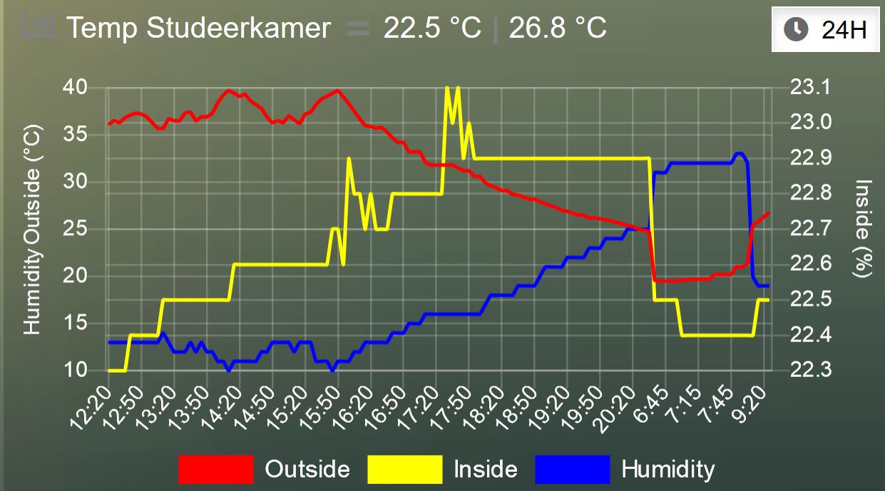

But I want "today" be te default not "Last hours"
This doesn't work:
blocks['graph_5'] = {
	devices: [Temp_Studeerkamer,Weerstation],
	graphTypes : ['te', 'hu'],
	spanGaps: false,
	custom : {
		"24H": {
			range: 'day',
			filter: '24 hours',
			data: {
				Outside: 'd.te_5',
				Inside: 'd.te_11',
				Humidity: 'd.hu_5'
	legend: {
      'te_5': 'Outside',
	  'te_11': 'Inside',
	  'hu_5': 'Humidity'
	height : '300px'

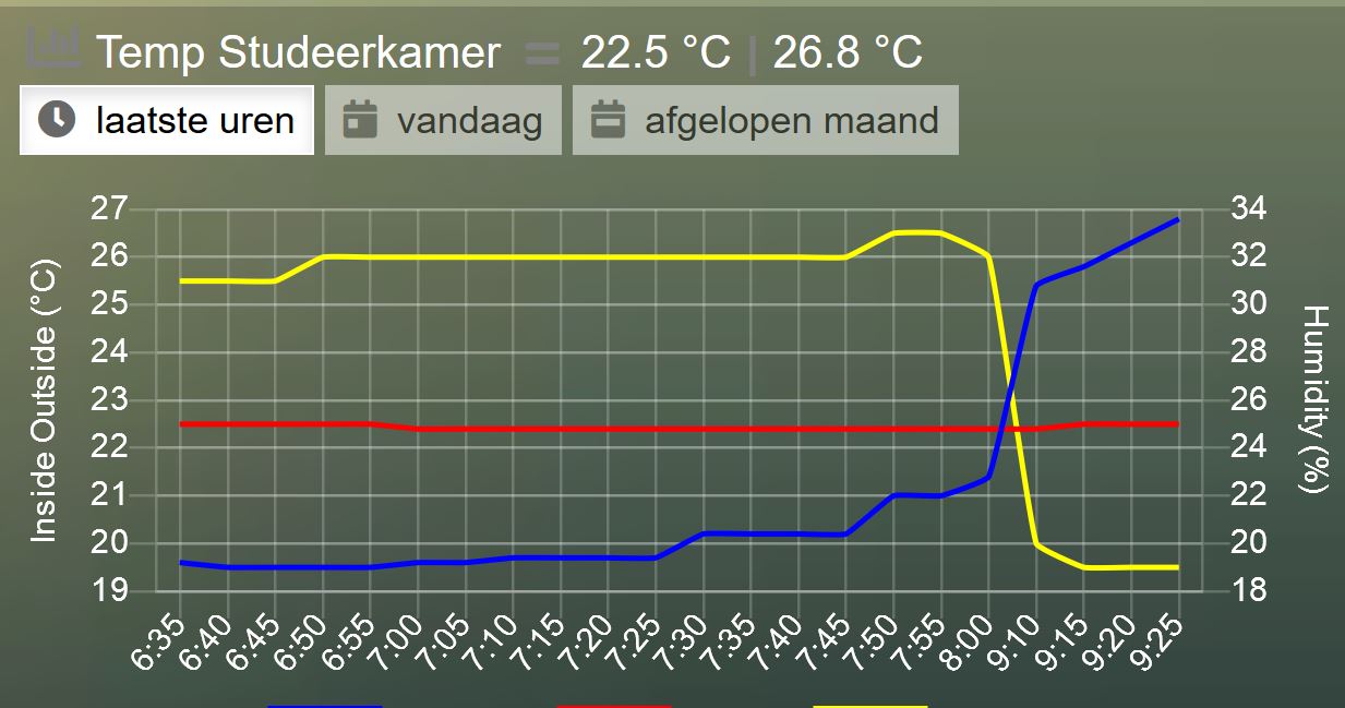

If I do the above, it places the the inside temperature and humidity on the right y-ax and the outside temperature on the left y-ax.
see this:
If I add CSS:
[data-id='graph_5'] .graphbuttons {
   display: none;
this is the result:
Last edited by Ewaldharmsen on Tuesday 03 March 2020 10:27, edited 2 times in total.

Ewaldharmsen wrote: Tuesday 03 March 2020 9:24 This works now, but spanGaps: doesnt do anything, I stil have a gap in my graph, even if I make it true:
I cannot see any gaps in your lines, so I am not clear on what you are trying achieve.
Ewaldharmsen wrote: Tuesday 03 March 2020 9:24 But I want "today" be te default not "Last hours"
Ensure this is in your config.js
config['standard_graph'] = 'day';
EdwinK wrote: Tuesday 03 March 2020 9:44 It places the the inside temperature and humidity on the right y-ax and the outside temperature on the left y-ax.
If you add custom data, you don't have to specify a custom legend too. Just try legend: true.
Ewaldharmsen wrote: Tuesday 03 March 2020 9:24 If I add CSS this is the result:
Is that not what you wanted?

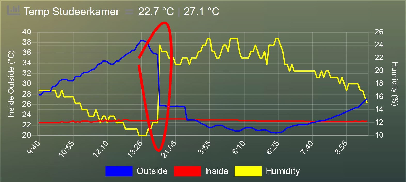

Ewaldharmsen
Posts: 130
Joined: Tuesday 07 February 2017 15:00
Re: Dashticz Graphs - New Features, Fixes & Updates
Post by Ewaldharmsen »
thank you very much!
I could not find
in the manual.
That one works now.
But the gap is there still, I highligted it in red:
My current code is:
blocks['temperature'] = {
	spanGaps: true,
	maxTicksLimit: 10,
	legend: {
     	 'te_5': 'Outside',
	  'te_11': 'Inside',
	  'hu_5': 'Humidity'
	height : '300px'
clinkadink
Posts: 417
Location: Swindon, UK
Post by clinkadink »
Ewaldharmsen wrote: Wednesday 04 March 2020 9:49 But the gap is there still, I highligted it in red:
spanGaps will span any gaps (breaks) in a line. You do not have any gaps. The graph is accurately displaying the data provided from Domoticz. Understandably, If you want the graph to accurately report on the sensor for those 6 hours, the sensor needs to be on and providing data.
Ewaldharmsen
Posts: 130
clinkadink wrote: Wednesday 04 March 2020 13:04
I still quite get it. I have 2 sensors one of which is alwasy on. The other not. The data of my always-on sensor is not showing because the other sensor has missing data.

Janco wrote: Saturday 07 March 2020 8:08 I know what mean. It's just that for some reason the debug file didn't upload (maybe because I made a draft first?).
Thanks for the log. I think I have found the issue, if I'm right, this only applies to graphs with multiple devices, each with multidata, but no Y labels specified in the custom data. I have tested my humidity/temp devices and the correct unit of measure is displayed.
As a test, please can you try changing this ...
"data": {
   "Temperature": "d.te_158",
   "Humidity": "d.hu_158",
   "Pressure": "d.ba_161"
To this ...
"data": {
Please let me know if this corrects the Y axis label issue?
