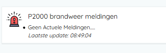

Yesterday I've added the alarmeringen to my Dashticz:
blocks['alarmmeldingen'] = {
        title: '112 meldingen Doetinchem',
        rss: 'https://alarmeringen.nl/feeds/city/doetinchem.rss',
        show_lastupdate: true,
        width: 12,
        refresh: 300,   //refresh rate in seconds
        results: 5,   //number of recent results to show
        image: '../custom/img/112meldingen.png'
It showed up nicely, but dat no recent items.
Checking it today gives the same result:
Aantekening 2020-06-20 085340.png (8.43 KiB) Viewed 2173 times
I checked the RSS file and there where some calls this night. So there should be results in here... What am I doing wrong here?
Lokonli
Posts: 2292
Re: Dashticz - Module - 112 Meldingen (Dutch)
Post by Lokonli »
The title in the actual result ('P2000 brandweer meldingen') is not the same as in the block definition ('112 meldingen Doetinchem')
Can it be related to that? (do you maybe redefine the block somewhere?)

Droid
Posts: 19
Joined: Saturday 30 May 2020 16:42
Post by Droid »
Lokonli wrote: Saturday 20 June 2020 10:19 The title in the actual result ('P2000 brandweer meldingen') is not the same as in the block definition ('112 meldingen Doetinchem')
No, I've changed it in between... it is the same now.
I did some further digging... in alarmmeldingen.js I've added this line:
    function dataAlarmInfo(me, data) {
      console.log(data);
      var alarmobject = me.block;
      var html = '';
Then, checking the console, it says null
So no items were retrieved...

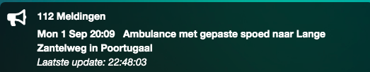

Screen Shot 2020-09-28 at 22.48.36.png (42.19 KiB) Viewed 1956 times
I got a strange date for an alert today. Somehow the system seems to think it's Mon September 1.
EdwinK
Posts: 1820
Location: Rhoon
Post by EdwinK »
Fixed. It should have been DD instead of dd

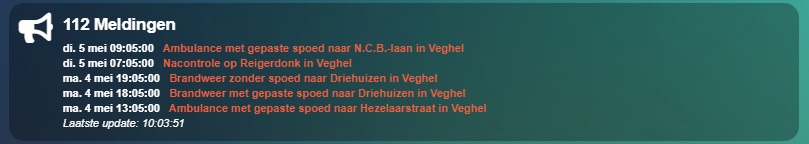

When I use this, I see the following:
[attachment=0]Screen Shot 2020-12-29 at 16.41.09.png[/attachment]
Screen Shot 2020-12-29 at 16.41.09.png (86.65 KiB) Viewed 1736 times
