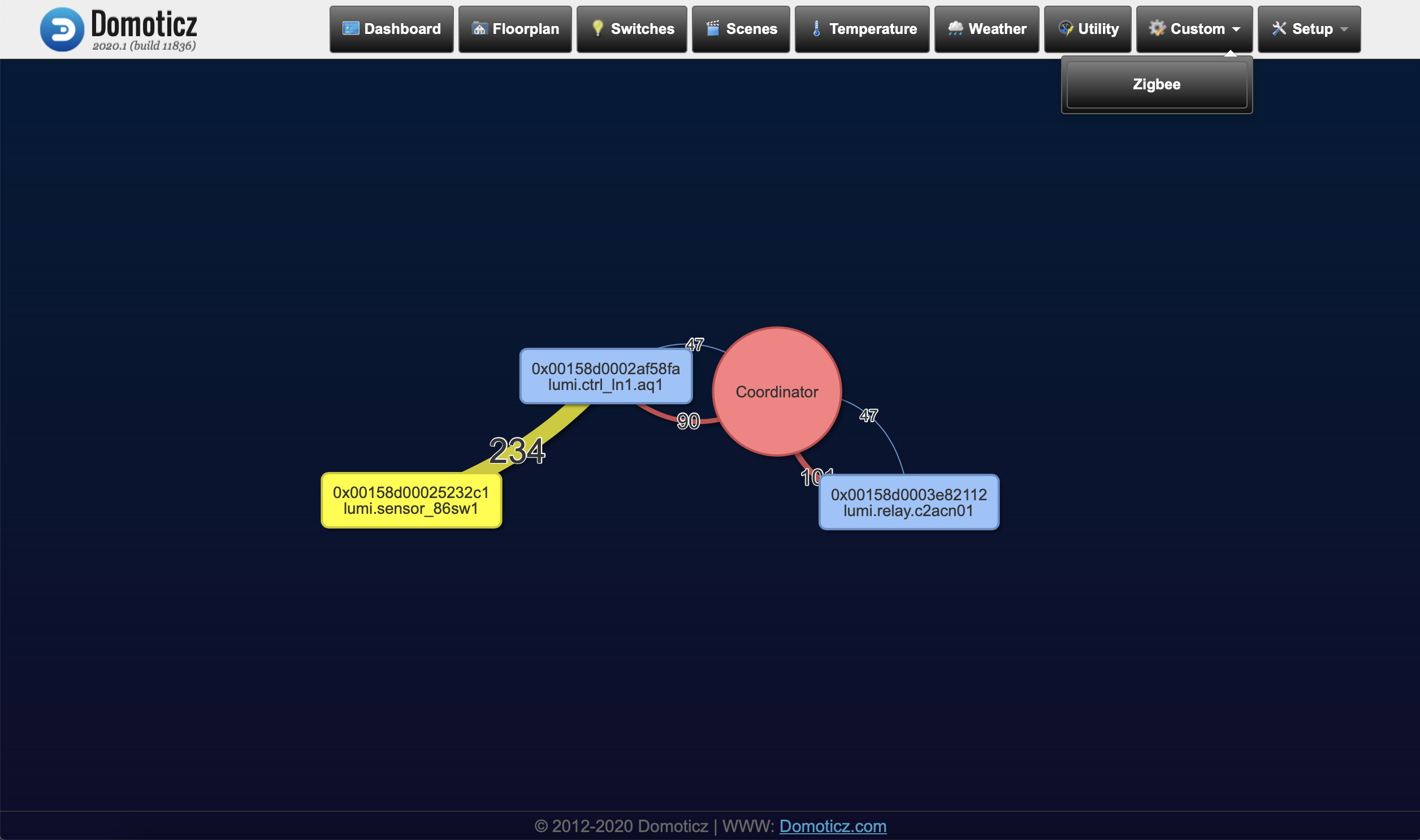

Simple network map for zigbee2mqtt plugin using custom template page
https://github.com/kovainfo/Domoticz-zi ... etwork-map

Re: Zigbee2mqtt network map
Post by Bigted »
Domoticz 4.10717
I can see raw.json gets populated
However the custom panel under Zigbee is blank
ak97
Posts: 39
Joined: Saturday 03 February 2018 18:42
Domoticz version: latest
Post by ak97 »
Bigted wrote: Sunday 05 April 2020 13:47 Domoticz 4.10717
Absolute paths are specified in the template and script. are they right?
Post by ak97 »
ok! that's it!
try modify file in /templates/zigbeemap/zigbeemap.html
and change
<script type="text/javascript" src="/js/jquery-3.4.1.min.js"></script>
to:
<script type="text/javascript" src="/js/jquery-3.3.1.min.js"></script>

ak97 wrote: Sunday 05 April 2020 14:20 ok! that's it!
and change
to:
Yep, I have images now! Great.
