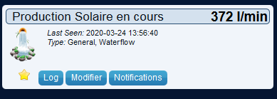

I bought an ECO-DEVICES device and connected it to a three-phase energy meter.
Everything works fine, only the flow rate in liters per minute is displayed.
Where can I change it?

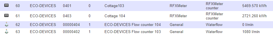

I don't know where to change it.
The hardware selection is directly in domoticz.
Everything is set correctly.
It should show right Wh.

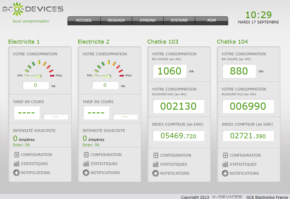

Picture from ECO-DEVICE:

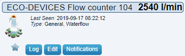

Picture from Domoticz Devices:

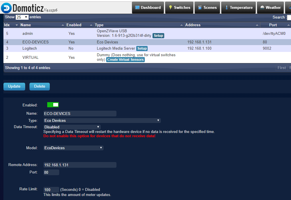

Picture from Domoticz Hardware
