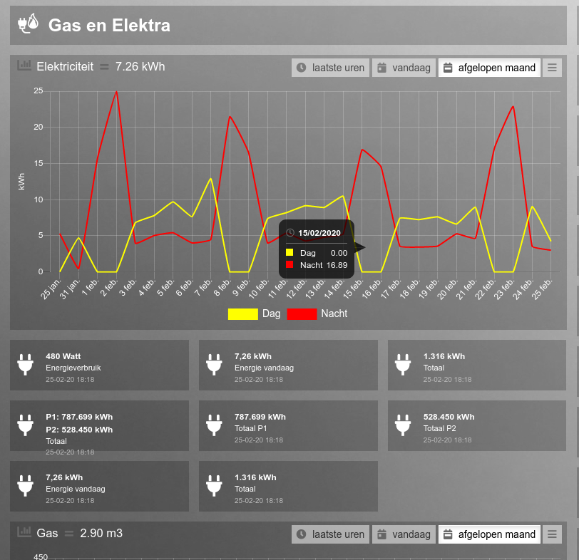

Nice, love the groupBy feature, exactly what I needed for my p1 meter graph. Love the zoom feature, too. Thank you!
It doesn't work very well with my temp/humidity chart though, the average temperature is somehow calculated as 8-10 degrees. I've commented out all the custom (mostly visual) options, but that doesn't make a difference..
Screenshot 2020-02-24 at 16.21.19.png (179.86 KiB) Viewed 2727 times

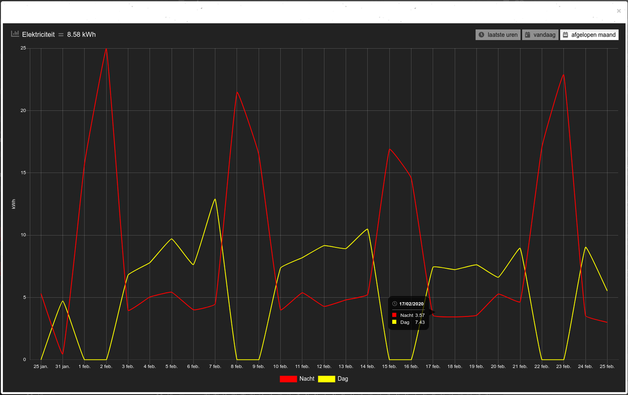

I am having trouble to get the custom popup showing. I tried my own notation (rem'ed out in below sample) and your anotation style. In both cases I am unable to get the popup graph to show up when I click the block "Elektra Nu".
I have replaced my custom.css by a backup version.
Definition of my variables:
// Gas en elektra
var elektra                    = 199;
var gas                        = 200;
var elektra_nu                 = '199_1';
var elektra_vandaag            = '199_2';
var elektra_totaal             = '199_3';
var grafiek_gas                = 'graph_200';
var grafiek_elektra            = 'graph_199';
The attempt to get the popup to show
// componenten gas en elektra
//blocks[elektra_nu] = {}
//blocks[elektra_nu]['width'] = 4;
//blocks[elektra_nu]['popup'] = 'popup_elektra_nu';
//blocks[elektra_nu]['show_lastupdate'] = false;
//blocks[elektra_nu]['protected'] = true;
	width: 4,
	popup: 'popup_elektra_nu',
	show_lastupdate: false,
//blocks['popup_elektra_nu'] = {}
//blocks['popup_ekektra_nu']['title'] = 'Electriciteit';
//blocks['popup_elektra_nu']['devices'] = [199];
//blocks['popup_elektra_nu']['toolTipStyle'] = true;
//blocks['popup_elektra_nu']['datasetColors'] = ['red', 'yellow'];
//blocks['popup_elektra_nu']['graph'] = 'line';
//blocks['popup_elektra_nu']['legend'] = {'v2_199': 'Dag', 'v_199': 'Nacht'}
    title: 'Electriciteit',
    devices: [199],
    toolTipStyle: true,
    datasetColors: ['red', 'yellow'],
    graph: 'line',
    legend: {
        'v_199' : 'Nacht',
        'v2_199': 'Dag',
        'c_199' : 'Totaal'
Any tips?
Greetz,
Sjonnie

clinkadink
Posts: 417
Location: Swindon, UK
Re: Multiple sources in one graph
Post by clinkadink »
Sjonnie2017 wrote: Monday 24 February 2020 19:19 I am having trouble to get the custom popup showing.
Did you remove your CSS tooltip styling from the last update? What happens when you click the block? Does any popup show? What happens when you add the popup graph to your column definition? Does it display correctly as a standard graph?

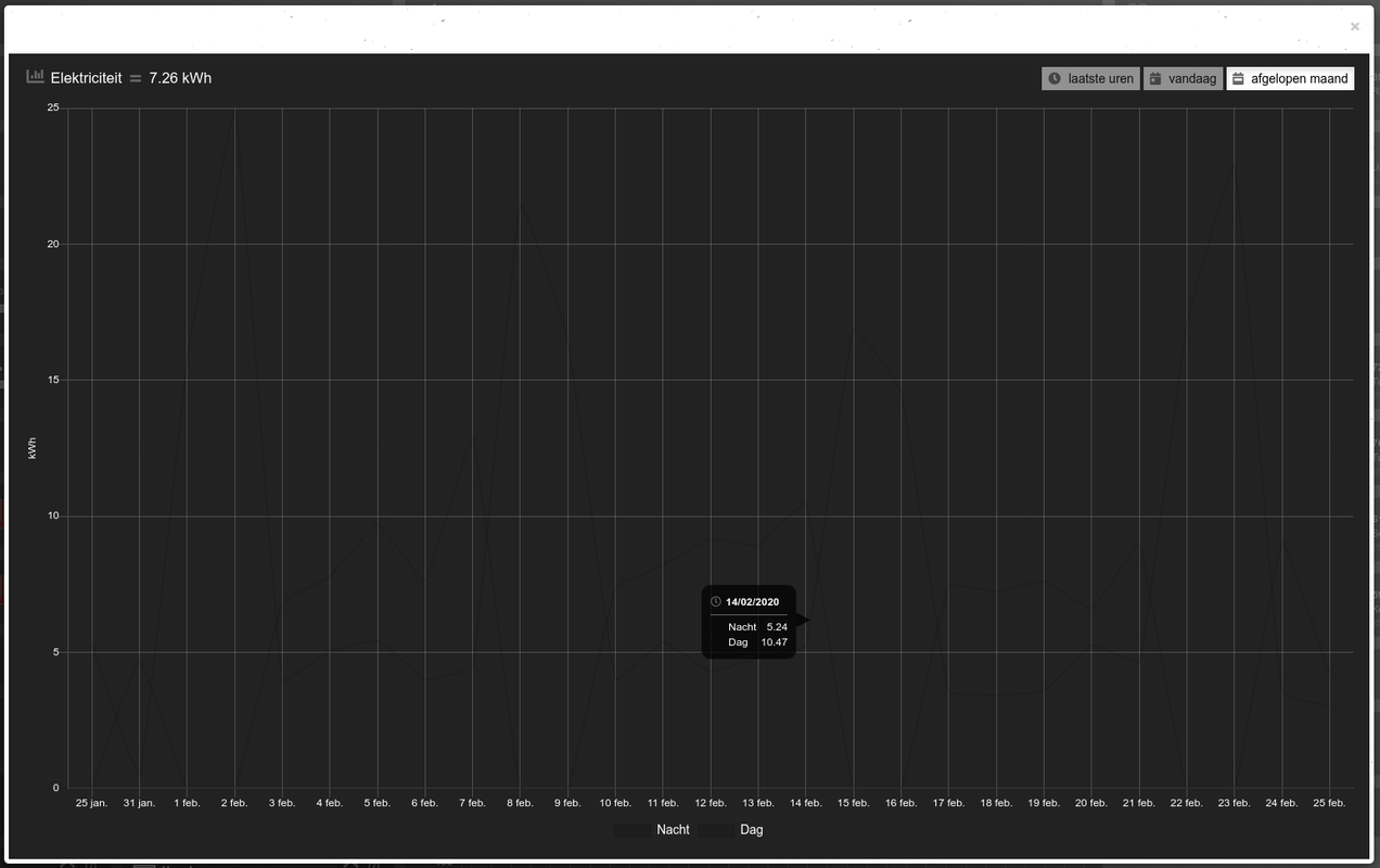

Sjonnie2017
Posts: 378
Joined: Wednesday 02 August 2017 19:43
Domoticz version: Latest ß
Post by Sjonnie2017 »
Thanks for your reply and suggestion. It lead to some unexpected results ;)
Note that I have an empty custom.css so that should not be the problem.
Bit stumped here...
Unexpected result on the dashboard:
A popup graph for the color blind :) :
Definition of the blocks:
blocks[199] = {
	width: 4,
	//show_lastupdate: false,
    title: 'Elektriciteit',
    devices: [199],
    toolTipStyle: true,
    datasetColors: ['red', 'yellow', 'blue'],
    graph: 'line',
    legend: {
        'v_199' : 'Nacht',
        'v2_199': 'Dag',
        'c_199' : 'Totaal'
Definition of column 2:
columns[2] = {}
columns[2]['blocks'] = [title_gas_en_elektra, grafiek_elektra, 199, elektra_vandaag, elektra_totaal, grafiek_gas, gas]
columns[2]['width'] = 5;
Greetz,
Sjonnie
EDIT: Changing 199 to '199_1' in the block definition and the columns caused the previous behavior (as one expected).
YouLess Energy meter
clinkadink
Posts: 417
The popup is showing the correct graph, but the dataset had no color assigned. I am guessing that your keys change for "month". Disable the defined popup, check the keys for month, update your defined popup blocks legend and dataset colors accordingly.
Sjonnie2017
Posts: 378
Ok, that works. I changed the dataset colors as follows:
    devices: [199],
    toolTipStyle: true,
    //datasetColors: ['red', 'yellow', 'blue', 'green', 'white', 'orange'],
    datasetColors: ['red', 'yellow', 'blue', 'red', 'yellow', 'aqua', 'red', 'yellow'],
    graph: 'line',
    legend: {
        'v_199' : 'Nacht',
        'v2_199': 'Dag',
        'c_199' : 'Totaal'
which leads to:

Sjonnie2017 wrote: Tuesday 25 February 2020 19:54 Ok, that works. I changed the dataset colors as follows:
Glad you got it working :D Don't forget, now that you can define your own popup block, you can also add the debug button to it, to help find out where the issue is.
