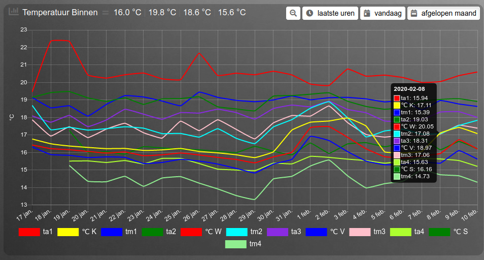

So with the above datasetColors the graphs for 'last hours' and 'today' look like these:
And the graph for last month looks like this:
The code I used for above graphs:
blocks['multigraph_144'] = {
	title: 'Temperatuur Binnen',
        devices: [ 144, 145, 152, 158],
        sortDevices: false,
	datasetColors: ['red', 'yellow', 'blue', 'green', 'beige', 'aqua', 'blueviolet', 'chartreuse', 'pink', 'greenyellow', 'indigo', 'lightgreen', 'seashell'],
	spanGaps: true,
	graph: 'line',
	legend: true
As @clinkadink explained te# for day and last hours is the actual temperature and tm# is used for last month and is the maximum temperature. And I think there lies the source of the "problem'.
If I change beige to yellow, chartreuse to blue and indigo to green (and filter the readings) then the better part of the graph for last month is looking fine:
And the code that goes with it:
        sortDevices: false,
	datasetColors: ['red', 'yellow', 'blue', 'green', 'yellow', 'aqua', 'blueviolet', 'blue', 'pink', 'greenyellow', 'green', 'lightgreen', 'seashell'],
	spanGaps: true,
	graph: 'line',
	legend: {
        'te1': '℃ K',
//	'ta1': '℃ K(avg)',
//	'tm1': '℃ K(min)',
        'te2': '℃ W',
//	'ta2': '℃ W(avg)',
//	'tm2': '℃ W(min)',
	'te3': '℃ V',
//	'ta3': '℃ V(avg)',
//	'tm3': '℃ V(min)',
	'te4': '℃ S'
//	'ta4': '℃ S(avg)',
//	'tm4': '℃ S(min)',
Somehow I think the color for TM1 is selected not as the third color (which I expected but also does not resolve my issue) but the second (yellow).
If anyone has a bright idea how to get tm1 to show up red in my graph without "ruining" the other two graphs I am "all ears" :lol:
Greetz,
Sjonnie

Thanks for the info.
The datasetColors will be applied to each key in the order they are returned. So in your case, red is the first key, "te1", yellow is the second key, "te2", etc. But when switching to month range, the data includes a new key, "ta1", which comes before "te1" alphabetically. And since red applies to the first key, "ta1" becomes red, and "te1" becomes yellow.
The code doesn't currently cater for this. One way to do this, would be creating a relationship between the key and the color. But that wouldn't be a simple change. Example:
legend: [
  { te1: "D1 Temp", keyColor: "red" },
  { ta1: "D1 Temp (avg)", keyColor: "yellow" },
  { tm1: "D1 Temp (min)", keyColor: "blue" },
  { hu2: "D2 Humidity", keyColor: "green" },
  { te3: "D3 Temp", keyColor: "grey" },
  { ta3: "D3 Temp (avg)", keyColor: "orange" },
  { tm3: "D3 Temp (min)", keyColor: "pink" },
  { ba3: "D3 Pressure", keyColor: "purple" }
Did you try sorting the draw order of the graphs? Check out the beta documentation, specifically drawOrderMonth.
drawOrderMonth: an array stating the order in which each dataset should be added to the graph for “last month”, e.g. [‘v1’, ‘v2’, ‘c1’, ‘c2’]
https://dashticz.readthedocs.io/en/beta ... raphs.html
Cheers ;)

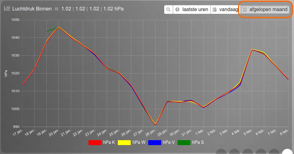

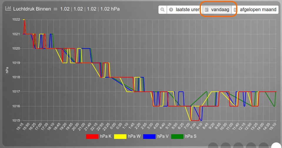

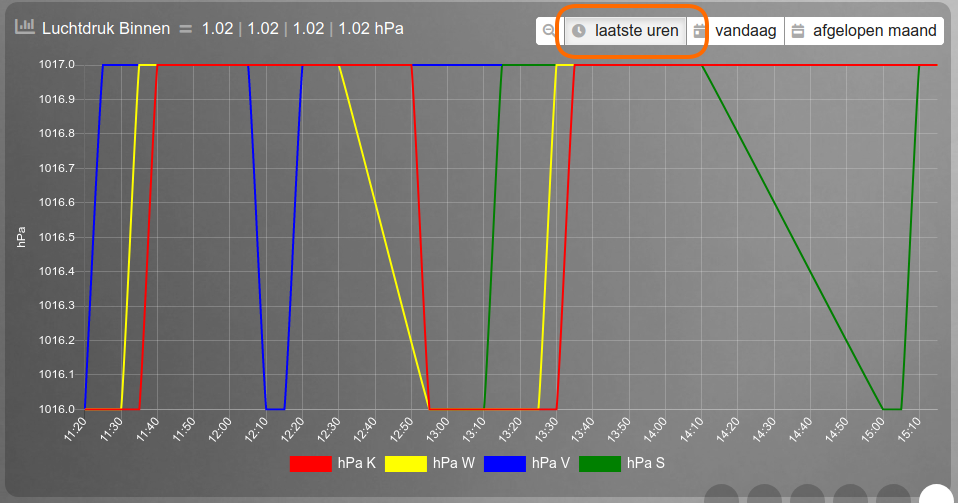

I have been working on my multi-graph for the barometer readings of the four Aqara sensors. That seemed to work out pretty nice :)
The graphs:
The code:
blocks['multigraph_147'] = {
	title: 'Luchtdruk Binnen',
    devices: [ 147, 149, 154, 160],
    sortDevices: true,
	datasetColors: ['red', 'yellow', 'blue', 'green', 'green', 'brown', 'yellow', 'aqua'],
	spanGaps: true,
	multigraphTypes: [ 'ba'],
	graph: 'line',
	legend: {
      'ba1': 'hPa K',
      'ba2': 'hPa W',
      'ba3': 'hPa V',
      'ba4': 'hPa S'

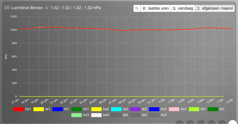

If I change this to legend is true and 'rem' out the legend apart you see above I get this (I am only showing Last Month):
The code:
    sortDevices: true,
	spanGaps: true,
	graph: 'line',
	legend: true
Somehow I think the two graphs are interpreted differently but I could be mistaken.

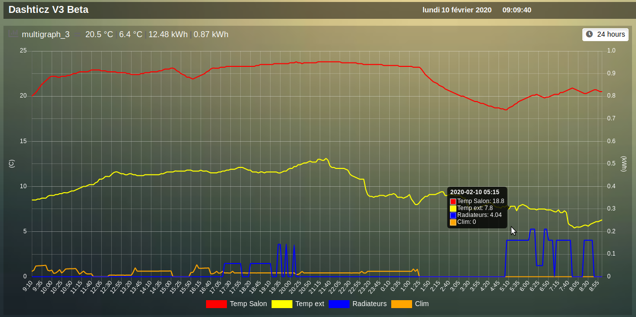

I tried to combine on one graph using multigraph, kwh and temperature (to correlate energy consumption and resulting heating), but the best i've succeed so far result in only one y axis. Could it be possible to define custom two Y axis (like the baro temp device graph) and let the user define which data is stuck to which axis ?

dgrostoto wrote: Monday 10 February 2020 1:08 Could it be possible to define custom two Y axis (like the baro temp device graph)?
This is now corrected in the latest beta. More info here:
https://www.domoticz.com/forum/viewtopi ... 67&t=31288

this is better (the legend top left now report good units).
But I still did not manage to get two axis functionnal, only the first one is used :
blocks['multigraph_3'] = {
devices : [ 3,103,101,158 ],
graphTypes: ['te','te','v','v'],
//drawOrderDay: ['te1', 'te2', 'v3', 'v4' ],
graph: 'line',
custom : {
"24 hours": {
range: 'day',
filter: '24 hours',
ylabels: [ 'C','kWh' ],
data: {
te1 : 'd.te1',
te2 : 'd.te2',
v3 : 'd.v3/1000',
v4 : 'd.v4/1000'
legend: {
te1: 'Temp Salon',
te2: 'Temp ext',
v3: 'Radiateurs',
v4: 'Clim'
(device 3 is te only, 103 is te + hu, both 101 and 158 are counter type general and subtype kWh)
the graph is attached below.
See the value pointed by mouse : they only use the left Yaxis and none of the data use Yaxis on the right.

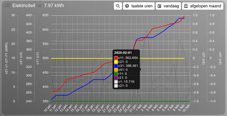

And another I noticed is my changed electricity graph:
Old:
New:
I love the legend on the Y-axis but am confused about all the (new) values.

How did you manage to get so many Yaxis ? can you post your graph defintion ? (and tell which type of devices are the devices declared in the block ?

I upgraded to latest beta (3.4.0) in which the Y-axis legends are introduced. I would show you my code but it would not make sense because the display of the graph is not what it is supposed to be. I am experimenting now with some info that I have found. Will post back soon.

Well I added/changed the blocks of the sensors with the "graphTypes" and now they look rather spiffy :)
[EDIT]: Could the websocket thingy be the cause of the sensors showing up so late? So to get that to work I should upgrade to beta branch of Domoticz?
Unfortunately my "old" electricity graph does not change (it already had the graphTypes defined in the block).
@dgrostoto: I don't think it will be mutch help to you but here is the code of my electricity graph:

dgrostoto wrote: Monday 10 February 2020 18:55 How did you manage to get so many Yaxis ? can you post your graph defintion ? (and tell which type of devices are the devices declared in the block ?
The graph will check all datasets and each unit of measure, e.g. °C, kmh, mm, etc. Any datasets that share the same unit of measure, will share the same Y axis. The keys in Sjonnie's graph have not been associated with any units of measure, so the raw key name is used, e.g. c1, c2, c3. Therefore, the graph creates a Y axis for each unique unit of measure - hence the 4 Y axes.
In other words, if all datasets are have unit of "°C", then there will be only one Y axis. Otherwise, there will be one per unit.

My graph avec two differents unit (celcius and kwh) but if i don't specify "ylabels" i only have one yaxis.
So what i did wrong ?
my code
	graph: 'line',
	custom : {
		"24 hours": {
			range: 'day',
			filter: '12 hours',
			data: {
				te1 : 'd.te1',
				te2 : 'd.te2',
				v3 : '5*d.v3/1000',
				v4 : '5*d.v4/1000'
	legend: {
		te1: 'Temp Salon',
		te2: 'Temp ext',
		v3: 'Radiateurs',
		v4: 'Clim'
