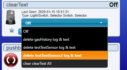

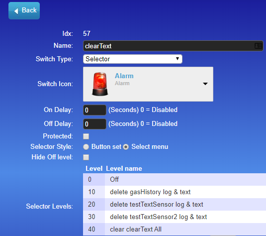

Can you try this one ?
read the comments in the script first. If anything is not clear please feel free to ask

            'clearText',    -- create as a virtual selector type switch. Levels 0 = 'Off',
                            -- 10, 20, etc.. like clear nameOfDevicetoClear log & text
                            -- name of the device to clear must be the second word in the level
