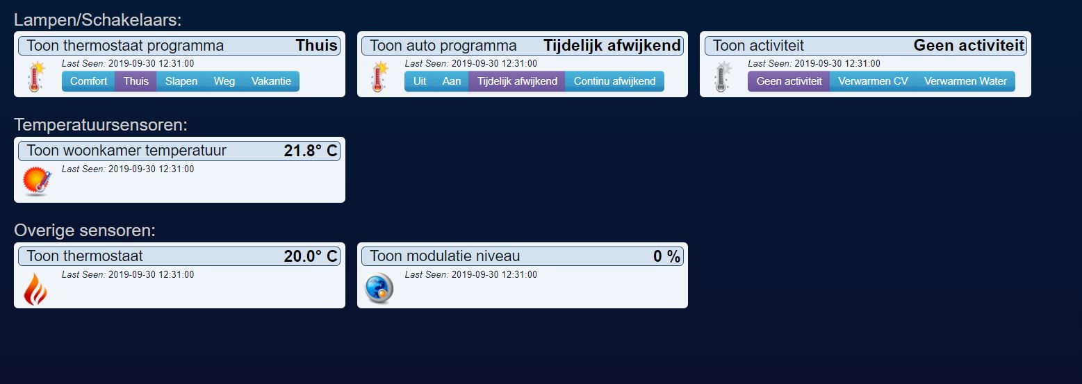

But today i had some time to make some test...
I thought it would be good to check if everything is working correctly by bringing the data to the domoticz logfiles.
After a lot if reading on the internet i found a solution...
This is what i have so far..
	on = {timer = {'every minute'}},
	execute = function(domoticz)
	local ToonIP     						= '192.168.1.61'
	local json 							= assert(loadfile "/usr/local/domoticz/var/scripts/lua/JSON.lua")()
	local handle 						= assert(io.popen(string.format('curl http://%s/happ_thermstat?action=getThermostatInfo', ToonIP)))
	local ThermostatInfo					= handle:read('*all')

I think i almoast finisching my script: ToonToDomoticz.
What do you think about it?

			execute = function(dz, item)
			-- INSTELLINGEN NAAR EIGEN SITUATIE --
			local toonIP 						= '192.168.1.61'			-- Toon thermostaat IP adres
			local DomoticzIpPoort				= '192.168.1.24:8085'		-- Domoticz IP adres + poort
			local IDX_ToonThermostaatProgramma	= '48'					-- IDX nummer Toon thermostaat programma keuze-schakelaar
			local IDX_ToonAutoProgramma			= '49'					-- IDX nummer Toon auto programma keuze-schakelaar
			local IDX_ToonThermostaat			= '50' 				-- IDX nummer toon thermostaat
			local IDX_KamerTemperatuur			= '51'					-- IDX nummer kamer tamperatuur
			local IDX_ModulatieNiveau				= '52'					-- IDX nummer modulatie niveau custom sensor
			local IDX_ToonActiviteit				= '53'					-- IDX nummer Toon activiteit keuze-schakelaar

I think i needed some help guys!
I made another small script to set my setpoint:
    devices = {'Toon thermostaat'}
    local ToonIp 			    = '192.168.1.61'
	local ThermostaatWaarde		= device.setPoint*100
	domoticz.log('Ingestelde temperatuur. 	= ' .. tostring(ThermostaatWaarde/100), domoticz.LOG_INFO)
	domoticz.openURL({
	url = 'http://'..
	ToonIp ..
	'/happ_thermstat?action=setSetpoint&Setpoint=' ..
	tostring(ThermostaatWaarde),
	method = 'GET',
The problem is that when my script: ToonToDomoticz is running (every minute) this script also is triggered.. so the url is send en then Toon api is thinking that the temperature is manualy changed and set the program to Manualy.
So how do i prefent that this script is triggered trough my other script?
Thnx! (hope you understand my broblem! :oops: )

This is my fully ToonToDomoticz script...
	local scriptVersion = '0.201909300100'
		local scriptVar  =  'ToonInfo_' .. scriptVersion

OedzesG
Posts: 106
Joined: Monday 11 March 2019 0:14
Re: Another noob question (toonInfo)
Post by OedzesG »
No special reason for URL, just becouse i know how to handle.
For now i changed everything.. but the same problem.
Domoticz triggers the ToonThermostaat script when updating the setpoint and after that when te temerature is changed by selecting a scene, Toon API is thinking that the temerature is changed manualy by setpoint.. en then changing the scene to manual..
ToonToDomoticz:

OedzesG wrote: Monday 30 September 2019 12:39 I think i almoast finisching my script: ToonToDomoticz.
return
timer = { 'every 1 minutes' },
httpResponses = { scriptVar }},
logging =
{level = domoticz.LOG_DEBUG,
marker = scriptVar,},
execute = function(dz, item, devices)
local toonIP                    = '192.168.0.4' -- Toon thermostaat IP adres
local IDX_ToonScene             = 332 -- IDX nummer Toon thermostaat scene keuze-schakelaar
local IDX_ToonAutoProgramma     = 333 -- IDX nummer Toon auto programma keuze-schakelaar
local IDX_ToonThermostaat       = 334 -- IDX nummer toon thermostaat
local IDX_ToonKamerTemperatuur  = 335 -- IDX nummer kamer tamperatuur
local IDX_ToonModulatieNiveau   = 336 -- IDX nummer modulatie niveau custom sensor
local IDX_ToonActiviteit        = 337 -- IDX nummer Toon activiteit keuze-schakelaar
-- HIERONDER NIETS MEER VERANDEREN !! --
local function getToonInfo()
local url = 'http://' .. toonIP .. '/happ_thermstat?action=getThermostatInfo'
dz.openURL ({ url = url, callback = scriptVar })
local function processResult(jsonThermostatInfo)
local domoticz = dz
-- TOON SCENE --
local toon_scene = tonumber(jsonThermostatInfo.activeState)
if toon_scene == -1 then domoticz.log ('Programma Toon thermostaat = Handmatig')
elseif toon_scene == 0 then domoticz.log ('Programma Toon thermostaat = Comfort')
elseif toon_scene == 1 then domoticz.log ('Programma Toon thermostaat = Thuis')
elseif toon_scene == 2 then domoticz.log ('Programma Toon thermostaat = Slapen')
elseif toon_scene == 3 then domoticz.log ('Programma Toon thermostaat = Weg')
elseif toon_scene == 4 then domoticz.log ('Programma Toon thermostaat = Vakantie')
if toon_scene == -1 then toon_scene = 0
elseif toon_scene == 0 then toon_scene = 10
elseif toon_scene == 1 then toon_scene = 20
elseif toon_scene == 2 then toon_scene = 30
elseif toon_scene == 3 then toon_scene = 40
elseif toon_scene == 4 then toon_scene = 50
domoticz.devices(IDX_ToonScene).switchSelector(toon_scene)
-- TOON AUTO PROGRAMMA --
local auto_programma = tonumber(jsonThermostatInfo.programState)
if auto_programma == 0 then domoticz.log ('Toon automatisch programma = Uit')
elseif auto_programma == 1 then domoticz.log ('Toon automatisch programma = Aan')
elseif auto_programma == 2 then domoticz.log ('Toon automatisch programma = Aan met tijdelijk afwijkend programma')
elseif auto_programma == 8 then domoticz.log ('Toon automatisch programma = Aan met continu afwijkend programma')
if auto_programma == 0 then auto_programma = 0
elseif auto_programma == 1 then auto_programma = 10
elseif auto_programma == 2 then auto_programma = 20
elseif auto_programma == 8 then auto_programma = 30
domoticz.devices(IDX_ToonAutoProgramma).switchSelector(auto_programma)
-- TOON THERMOSTAAT --
local waarde_thermostaat = tonumber(jsonThermostatInfo.currentSetpoint) / 100
domoticz.log('Thermostaat = ' .. tostring(waarde_thermostaat), domoticz.LOG_INFO)
domoticz.devices(IDX_ToonThermostaat).updateSetPoint(waarde_thermostaat)
-- HUIDIGE KAMER TEMPERATUUR --
local kamer_temperatuur = domoticz.utils.round(tonumber(jsonThermostatInfo.currentTemp) / 100,1)
domoticz.log('Huidige woonkamer temp. = ' .. tostring(kamer_temperatuur), domoticz.LOG_INFO)
domoticz.devices(IDX_ToonKamerTemperatuur).updateTemperature(kamer_temperatuur)
-- MODULATIE NIVEAU --
local modulatie_niveau = tonumber(jsonThermostatInfo.currentModulationLevel)
domoticz.log('Modulatie niveau = ' .. tostring(modulatie_niveau), domoticz.LOG_INFO)
domoticz.devices(IDX_ToonModulatieNiveau).updateCustomSensor(modulatie_niveau)
-- TOON ACTIVITEIT --
local toon_activiteit = tonumber(jsonThermostatInfo.burnerInfo)
if toon_activiteit == 0 then domoticz.log ('Momenteel geen activiteit')
elseif toon_activiteit == 1 then domoticz.log ('Verwarmen CV')
elseif toon_activiteit == 2 then domoticz.log ('Verwarmen water')
if toon_activiteit == 0 then toon_activiteit = 0
elseif toon_activiteit == 1 then toon_activiteit = 10
elseif toon_activiteit == 2 then toon_activiteit = 20
domoticz.devices(IDX_ToonActiviteit).switchSelector(toon_activiteit)
-- main
if item.isTimer or item.isDevice then
getToonInfo()
elseif item.ok then -- statusCode == 2xx
local toonInfo = dz.utils.fromJSON(item.data )
processResult(toonInfo)
dz.log('Could not get (good) data from ' .. toonIP .. '\n' .. item.data ,dz.LOG_ERROR)
Using this script now. Next to do is the make the switches giving the switches the right names and such.
