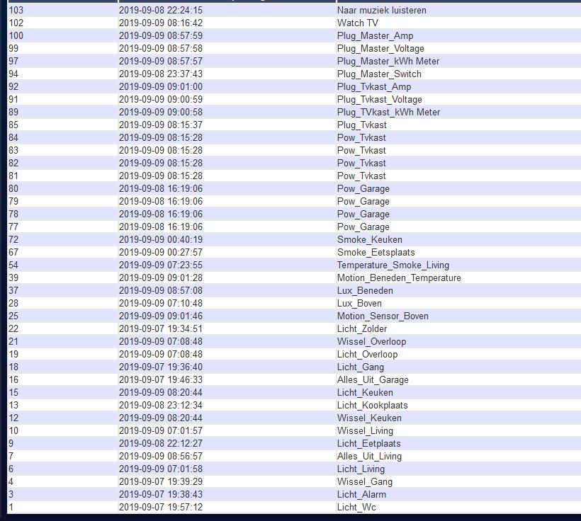

If i look in the dzvenst hardware tab there are no scenes only my devices
i would try to use the idx instead of the name but i notice that idx 1 en 2 exist in domoticz and controller?
Is this normal?
Is this normal?
Yes. Groups and devices have both their own range of ID's starting with 1 (same for uservariables, cameras, scripts, etc )

these ar all the devices in the dzvents
how can i use then the idx instead of the name in a script if the idx can exist more time's?
Re: There is no group or scene
Gianni wrote: Monday 09 September 2019 8:59 how can i use then the idx instead of the name in a script if the idx can exist more time's?
Because you never use it in isolation. dz.devices(1) is something else as dz.groups(1) or dz.variables(1)

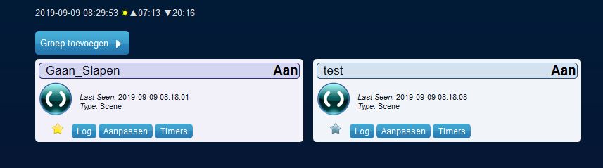

made some progress
the switch(Alles_Uit_Living/) go on and off but the scene is not triggered
The light living will not go off
this is my testscene

i think it's works now
I add this to th cocde
  if item.state == "On" then
            dz.scenes(myScene).switchOn()-- You cannot switch a scene to Off, only groups and devices
              item.switchOff().afterSec(3).silent()       -- Masterswitch will return to On state after 3 seconds without triggering any script
