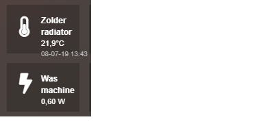

here is my config...
i did remove de /* ... */ to activate it...
these are all the trials...
the attached image is a little bit older then the config (no update date anymore , i added: last_update....

- Naamloos.png (6 KiB) Viewed 1328 times

Lokonli
- Posts: 2296
Re: unwanted devices in dashticz
If you want to change the icon color for block 982_1 add the following to custom.css:pvklink wrote: Monday 08 July 2019 16:07 noop, still does not work..
blocks['982_1'] = {}
blocks['982_1']['title'] = 'Was machine';
blocks['982_1']['icon'] = 'fas fa-bolt';
blocks['982_1']['hide_data'] = true;
blocks['982_1']['width'] = 3;
blocks['982_1']['switch'] = true;
blocks['982_1']['last_update'] = false;
blocks[1025] = {}
blocks[1025]['title'] = 'Zolder radiator';
blocks[1025]['hide_data'] = true;
blocks[1025]['switch'] =true;
blocks[1025]['width'] = 3;
blocks[1025]['last_update'] = false;
css
/* .block_982 .fa-bolt.on {color: red;} WERKT NIET */
/* .block_982 .fa-bolt.off {color: lightgrey;} WERKT NIET*/
/* .block_982_1 .icon.on {color: red !important;} WERKT NIET */
/* .block_982_1 .icon.off {color: red !important;} WERKT NIET */
/* .fa-bolt.on {color: red !important;} WERKT NIET*/
/* .fa-bolt.off {color: green !important;} WERKT NIET*/
/* .fas.fa-bolt.on {color: red !important;} WERKT NIET*/
/* .fas.fa-bolt.on {color: green !important;} WERKT NIET*/
.block_982_1 .col-icon {
If you want to change the color depending on the data, then first add a class to the block via the afterGetDevices() function in custom.js:
function afterGetDevices(){
var device = alldevices['982'];
console.log(device);
var usage = parseFloat(device['Usage']);
console.log(usage);
if( usage >20){
$('div.block_982_1').addClass('warning');
else {
$('div.block_982_1').removeClass('warning');
.warning .col-icon {
color: blue !important
}If it's working you can remove the two console.log statements.
