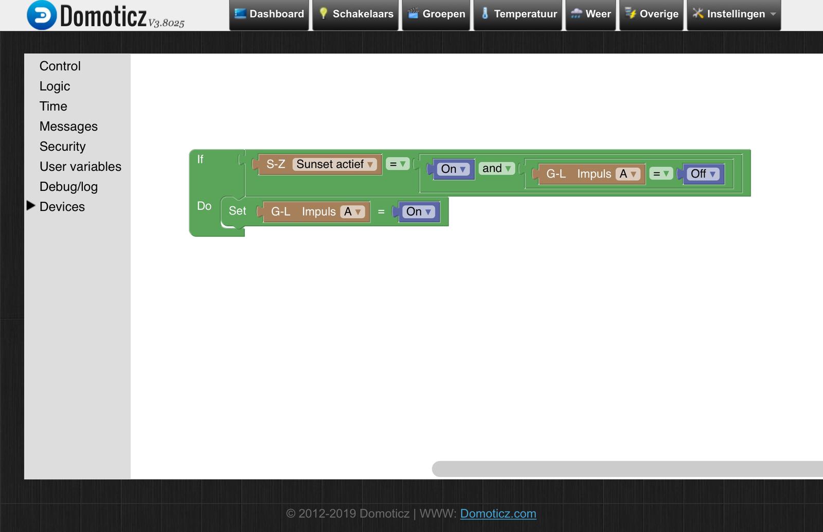

I’m very new to Domoticz and Blockly, so can anyone tell me why this script isn’t working?

‘Sunset actief’ is a dummy switch that turns on at sunset.

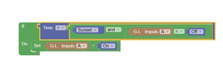

Try, if time = sunset then .......

allready tried this one, but does not work as well.

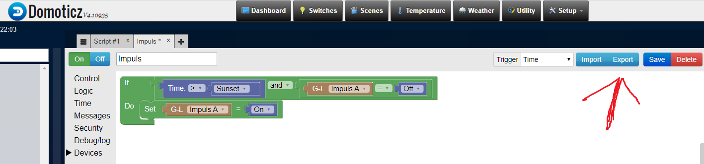

  • Time = sunset
is only valid one minute a day. So if you want this to be true after sunset then try this.

Allready tried it... does not work. Is the script good?

jellex87 wrote: Friday 28 June 2019 14:23 [Already tried it... does not work. Is the script good?
You should also look where the AND is placed. In your first post it is in the wrong place.

jellex87 wrote: Friday 28 June 2019 15:46 can't find the way to export the Blocky. Please let me know.
Press the export button, [ctrl]a, [ctrl]c, goto forum, [ctrl] v, strip garbage before <xml, strip out last line (Ok)

Don't have that menu on Synology. I will look for an update first.

You could use the time in between to split-up the Blockly.
So create a small Blockly where you only check if time > sunset and write something to the log and a second small blockly where you check the other condition and write something to the log. If they both work you can try with an AND between the two conditions.
