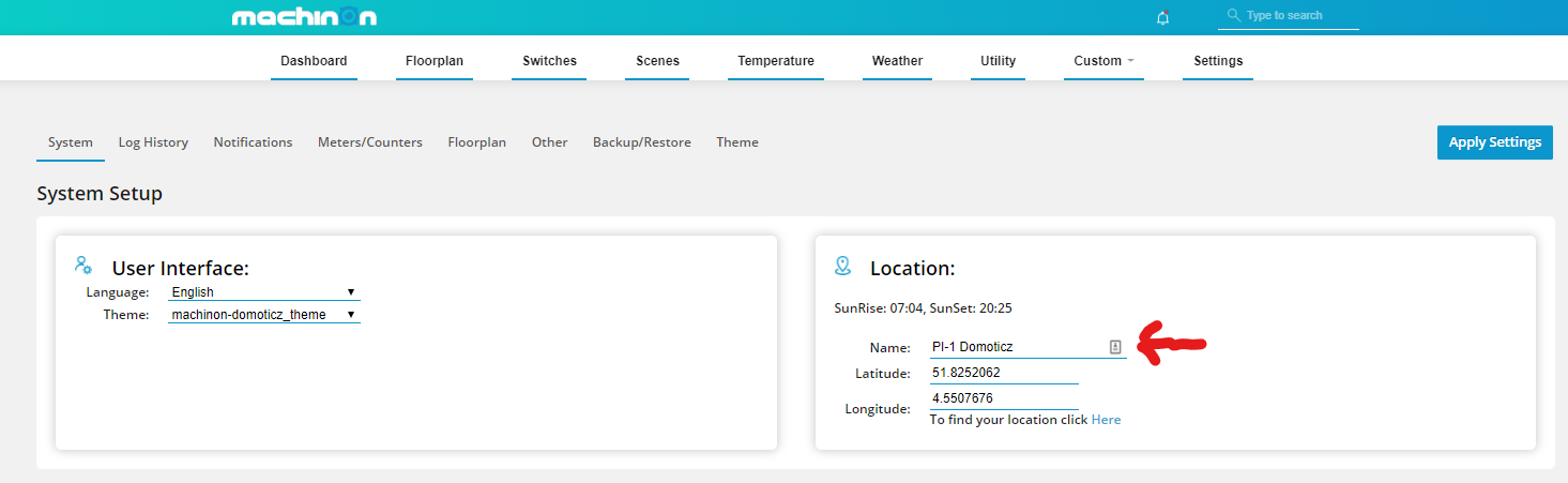

with dzVents (= Lua) and if you use a recent beta, you can identify the name of your system by the atrribute domoticz.settings.location.name which shows the Name you set in Location
System settings location

waaren wrote: Sunday 07 April 2019 12:39
Rohald wrote: Sunday 07 April 2019 7:27 I have multiple RPI's with domoticz which all use the same scripts. In Bash I know how to select on which host the scripts runs.
Is that also possible with LUA? And how could this be configured?
Thx works great!!!!
