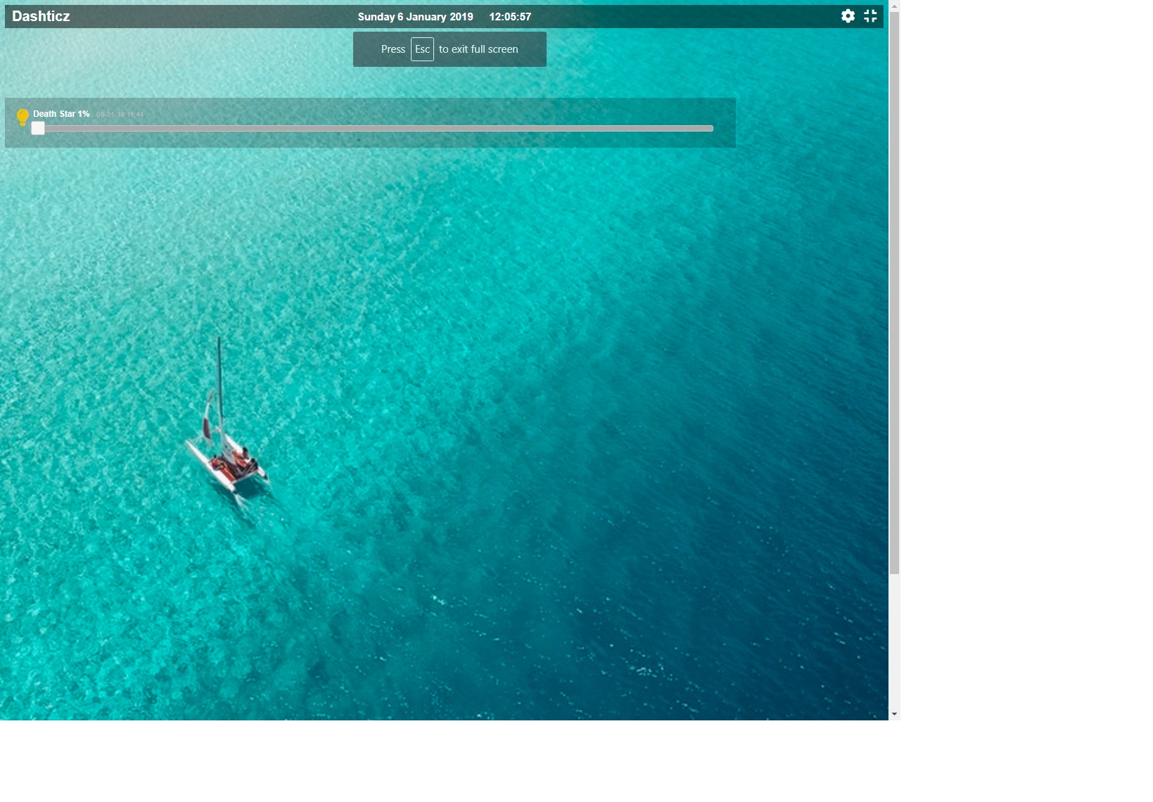

Post by alarm_guy1 »
Hi guys, just getting into Dashticz, Looking to create a Single Large button to control 1 switch and Maybe a scene too.
I can seem to make my switch wider but not fatter.
I have cut the Config right down,
var config = {}
config['domoticz_ip'] = 'http://xxx.xxx.xxx.xx:xxx';
config['dashticz_refresh'] = '1';
config['auto_positioning'] = '0';
config['user_name'] = '';
config['pass_word'] = '';
var publictransport = {}
var tvguide = {}
var _STREAMPLAYER_TRACKS  	= [
var buttons = {}
var blocks = {}
var columns = {}
columns[1] = {}
columns[1]['blocks'] = ['blocktitle_1',34]
columns[1]['width'] = 5;
var columns_standby = {}
columns_standby[1] = {}
columns_standby[1]['blocks'] = []
var screens = {}
screens[1] = {}
screens[1]['background'] = 'background_sea.jpg';
screens[1]['columns'] = [1,]
The item in Question is a Dimmer, and literally I want it as an on/off switch for this scenario, so you can just come in and touch the screen without
looking particularly and switch the light off (as we do with a switch), so my problem is 2 fold how do I make Dashticz see it as a switch and how do I make it Fill the screen.
Screen Shot attached of how it is presently
Cheers
HansieNL
Posts: 994
Post by HansieNL »
@alarm_guy1 :
What if you create a dummy on/off switch in Domoticz and use that one in Dashticz.
Blah blah blah

alarm_guy1
Posts: 132
Joined: Tuesday 14 January 2014 0:03
dummy switch sorted and working cheers...
