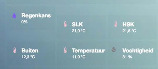

Found this, little, problem with my dashboard. As you can see, two of the tiles are a bit lower than the first one. At first I thought it was because the data was too much to handle in the box, but that isn't the case. Any clue's on this?

- Posts: 2296
I would expect it's something in your custom.css.EdwinK wrote: Sunday 11 November 2018 18:48 Screen Shot 2018-11-11 at 18.45.24.pngFound this, little, problem with my dashboard. As you can see, two of the tiles are a bit lower than the first one. At first I thought it was because the data was too much to handle in the box, but that isn't the case. Any clue's on this?
If you create an empty custom.css does the problem then disappear?
And with your own custom.css:
If you remove the 'regenkans' block from your CONFIG.js do you then still see the problem?
And if you remove the SLK-block? or the HSK-block?

- EdwinK
- Posts: 1820
- Domoticz version: BETA
- Location: Rhoon
I have it fixed by changing the size of some of those tiles.Lokonli wrote: Wednesday 14 November 2018 20:56I would expect it's something in your custom.css.EdwinK wrote: Sunday 11 November 2018 18:48 Screen Shot 2018-11-11 at 18.45.24.pngFound this, little, problem with my dashboard. As you can see, two of the tiles are a bit lower than the first one. At first I thought it was because the data was too much to handle in the box, but that isn't the case. Any clue's on this?
