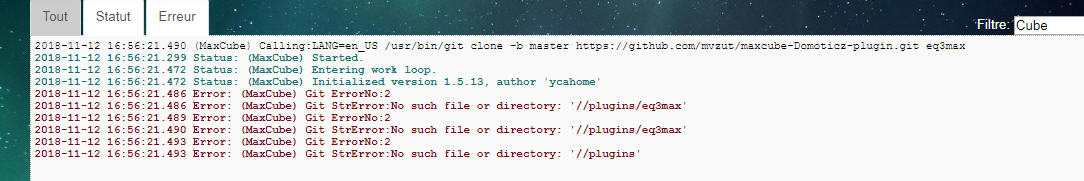

this is not working with Synology
I tryed to install eq-3 max
I had some errors
I can be a beta tester for Synology if needed
To make it work I had to launch the command my self ... but in sudo mode
I had some errors
- max.jpg (62.09 KiB) Viewed 5563 times

Others have successfully installed the plugin (directly) on Synology. So I assume your errors have to do with the Plugin Manager. If there is anything I can do (as eQ-3 Max! plugin author) please let me know.nono212 wrote: Monday 12 November 2018 17:00 this is not working with Synology
I had some errors

nono212
- Posts: 39
- Joined: Sunday 18 December 2016 13:47
- Domoticz version: 3.6179
Re: Python Plugin: Python Plugin Manager
Sorry the name is not correct in the image ...
the name MaxCube is not correct it should be pp_manager

According to the information on the screen there should be a new buton with devices, unfortunately nothing to find on the devices tab.
However, the plugin seems to work according to the log file.
Some error messages are given at the start of the plugin. see the log file
2019-02-09 15:20:26.451 Error: (Python Plugin Manager) Git ErrorNo:2
2019-02-09 15:20:26.451 Error: (Python Plugin Manager) Git StrError:No such file or directory: '/home/pi/domoticz/plugins/PP-MANAGER'
2019-02-09 15:20:26.462 Error: (Python Plugin Manager) Git ErrorNo:2
2019-02-09 15:20:26.462 Error: (Python Plugin Manager) Git StrError:No such file or directory: '/home/pi/domoticz/plugins/PP-MANAGER'
The question now is of course where is the devices buton
and what is wrong (see the error) and how can I solve these problems?
Thank you for your help
Cobra045
I tried to install the Python PP Plugin Manager today on my Domoticz 4.97
