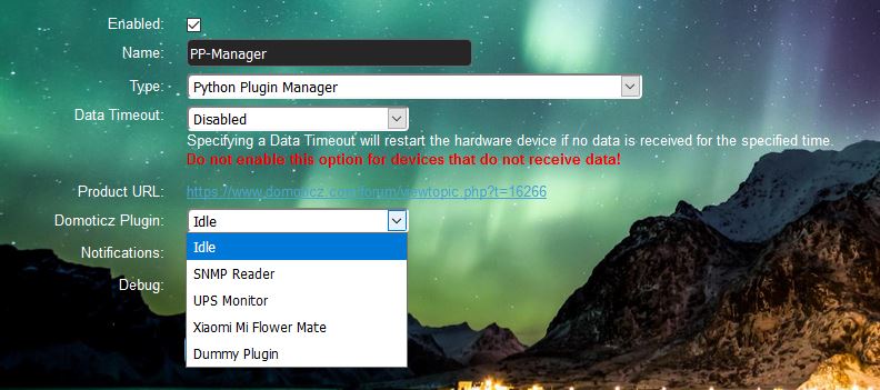

Some thoughts became code.
What if we could use a plugin in order to install other plugins from a list?
So, I did it.
Wiki Link: https://www.domoticz.com/wiki/Python_Plugin_Manager (Thanks to IDANIT)

FEATURES:
This plugin
  • supports only plugins located on GitHub
  • has a predefined list of plugins to be installed
  • performs plugin installation only if plugin directory not exists
  • performs plugin installation and prompts you to restart Domoticz in order to activate it.
  • Self updates itself on every self.stop() or plugin update
  • option to update selected plugin (ad-hoc update) every 24 hours
  • check for updates for currently installed plugins and notify admin
To install a plugin: select it on "Domoticz Plugin" field and press update
"Auto Update" Options (After every change press "Update")
  • "All": Continuously update all plugins
  • "Selected":Continuously update selected plugin (You should first select desired plugin from "Domoticz Plugin" field)
  • "All (NotifyOnly)": Check all plugins for updates and generate notification email.
  • "Selected (NotifyOnly)":Check selected plugin for updates and generate notification email. (You should first select desired plugin from "Domoticz Plugin" field)
To install another plugin, just select it and press update.
