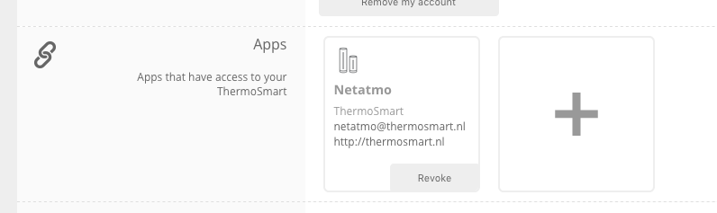

For the past few weeks that I cannot control Thermosmart thermostat from Domoticz. The system keeps saying invalid password, even though I am sure I am using the correct one.
 2018-11-16 11:00:30.444 Status: Thermosmart: Worker stopped...
2018-11-16 11:00:30.445 Status: Thermosmart: Worker started...
2018-11-16 11:00:37.170 Error: Thermosmart: Error login!, check username/password
On Thermosmart Apps website, I remember having an entry for Domoticz, but it's not there anymore
Screen Shot 2018-11-16 at 11.10.55.png (24.09 KiB) Viewed 1312 times
Am I missing something or is this a known bug?

I have this problem for more than a year also. Changed my password to something more simple, but it didn't help :x
Update: tried the beta version of Domoticz; also not succesful.
I have sent an email to the Thermosmart helpdesk.

It still doesn't work: I can just give in my username and (simple) password, that works with https://my.thermosmart.nl. No joy though, it doesn't work: "Error: Thermosmart: Error login!, check username/password".
Do I need to use the Hardware ID and the password that are on the backside of the device somewhere?

I get that error sometimes, when I look in the log after starting Domiticz, but a few seconds later login is successful. It's as if there is a timeout or something. Like it takes too long for the Thermosmart server to respond.
