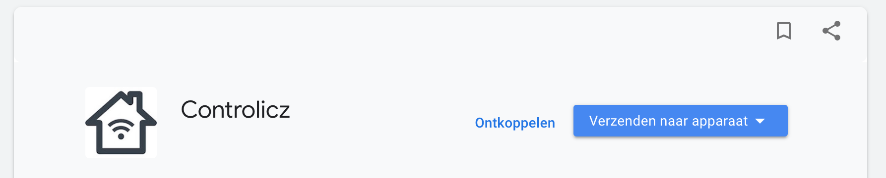

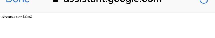

i try to add controlicz but for some reason i can't get it to work.
The app tells me that the accounts are now linked but i do not see it in the list of my devices.
So i tried to send it to the device in this link:
https://assistant.google.com/services/a ... 8ba2?hl=nl
But my home mine replies: "sorry, i could not find that"
Yes, i subscribed to controlicz so i don't understand why it won't work.

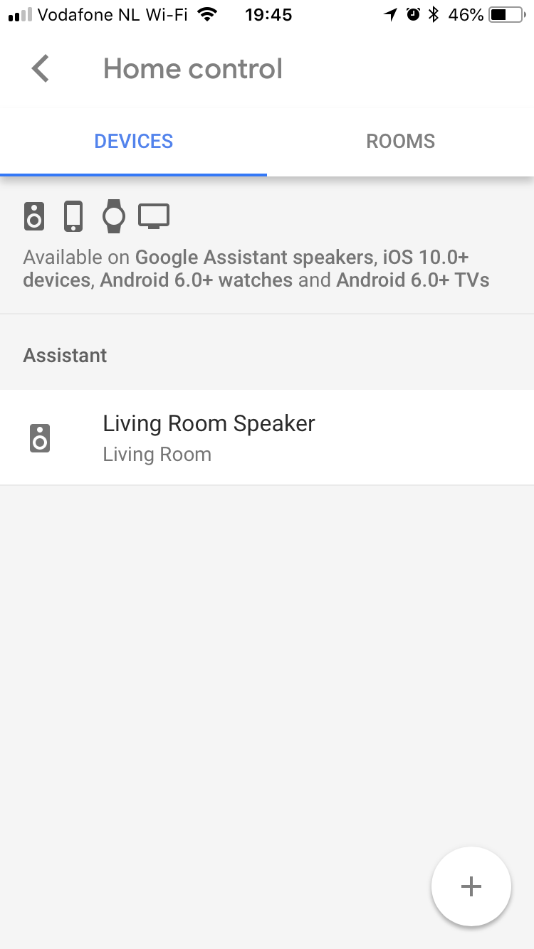

Madgeni wrote: Tuesday 30 October 2018 19:48 hi - just make sure you put the devices you want to control into a Room Plan in Domoticz, then it should work.
I just did.
But i still don't see my devices under Home Control and when i say "hey google versterker status aan" it still wont work.
On the controlicz website i see that my devices are on a room plan
And when i try to send ti to the device with:
the home mini still tells me "sorry, i couldn't find that"

Madgeni
Posts: 1571
Re: Controlicz - Domoticz to Google Home/Assistant integration
Post by Madgeni »
i see you've got two accounts (with a slightly different spelling) - can you mail me from your Controlicz profile, and i'll take a look for you?

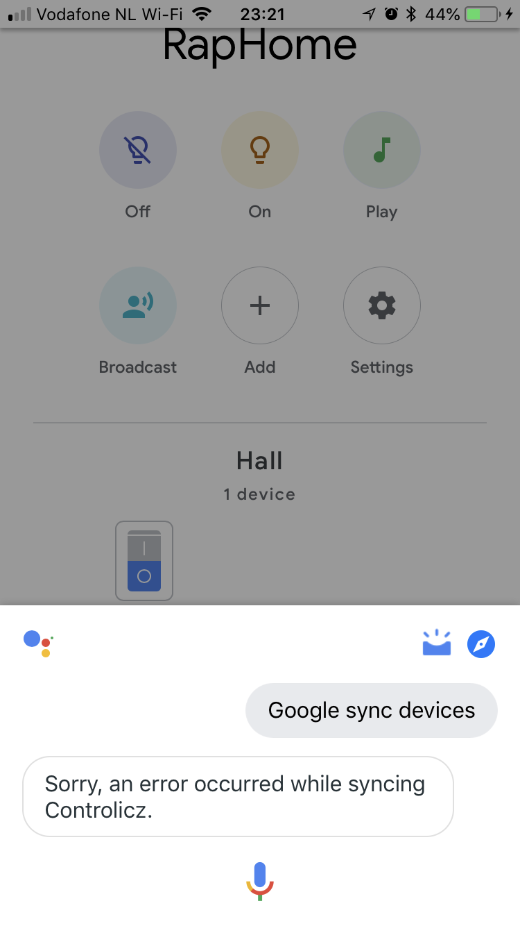

4. When i say “hey google... sync devices. I get an error
As you can see in the attachment.
5. Is a question... if i add another device to controlicz... do i realy have to unlink controlic and re add all the devices? That is a lot of work to do this over and over again.. especially if you rename devices and you have to re add all the devices iver and over again. You can not simply push the + sign to add a new controlic device...
1 + 3 - in Domoticz, under the device description, you can put Controlicz:insertfriendlynamehere and then Google can use that.
2: Currently Selector Switches aren't available - as soon as the ability to control them is available in Google, it will be available in Controlicz
4: you need to put "Sync my devices" (or Dutch equivalent) - you've put "Google sync devices"
5: see 4
