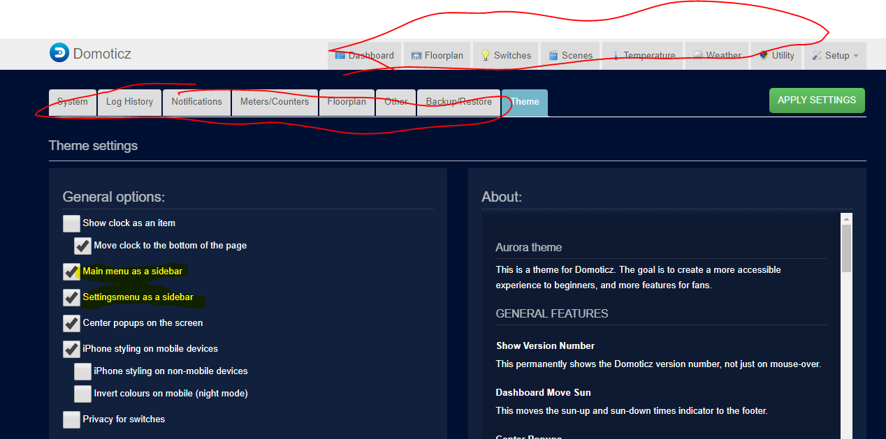

I tried this just now but it doesn't work.
If I uncheck the setting "Main menu as a sidebar" and check it again then the menu goes to the side. However, once I press "APPLY SETTINGS" the menu bar goes back to the top. The setting is still saved as checked, though.
