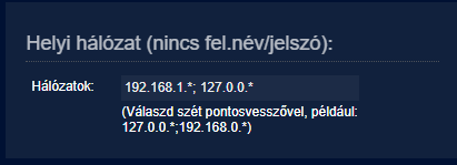

Hi,EdddieN wrote: Tuesday 10 July 2018 23:11 Running latest stable Domoticz 4.9700, suddenly today my http://IP_rpi:3002 works but my IP:3002/devices does not work. Any ideas?
Did you find a solution? I did a fresh install on V4.9700, but no success.
dextm80
- Posts: 117
- Joined: Tuesday 24 October 2017 18:32
- Domoticz version: 4.10159
Re: [MyDomoAtHome] Support thread
Post your error please, do you use auth access?lazara007 wrote:Hi,EdddieN wrote: Tuesday 10 July 2018 23:11 Running latest stable Domoticz 4.9700, suddenly today my http://IP_rpi:3002 works but my IP:3002/devices does not work. Any ideas?

lazara007
- Posts: 14
- Joined: Monday 30 March 2015 14:36
Domoticz Version: 4.10160dextm80 wrote: Friday 02 November 2018 20:18Post your error please, do you use auth access?lazara007 wrote:Hi,EdddieN wrote: Tuesday 10 July 2018 23:11 Running latest stable Domoticz 4.9700, suddenly today my http://IP_rpi:3002 works but my IP:3002/devices does not work. Any ideas?
node -v
v4.3.2
root@Domoticz:/home/pi# npm -v
2.14.12
root@Domoticz:/home/pi# sudo service mydomoathome status
* mydomoathome.service - MDAH ISS Rest interface for Domoticz to Imperihome
Loaded: loaded (/etc/systemd/system/mydomoathome.service; enabled)
Active: active (running) since Fri 2018-11-02 16:05:58 CET; 16h ago
Process: 10859 ExecReload=/bin/kill -HUP $MAINPID (code=exited, status=0/SUCCE SS)
Process: 10874 ExecStartPre=/bin/chmod 755 /run/mydomoathome (code=exited, sta tus=0/SUCCESS)
Process: 10871 ExecStartPre=/bin/chown www-data:www-data /etc/mydomoathome/con fig.json (code=exited, status=0/SUCCESS)
Process: 10868 ExecStartPre=/bin/chown www-data:www-data /run/mydomoathome (co de=exited, status=0/SUCCESS)
Process: 10865 ExecStartPre=/bin/mkdir -p /run/mydomoathome (code=exited, stat us=0/SUCCESS)
Main PID: 10877 (mydomoathome)
CGroup: /system.slice/mydomoathome.service
|- 3710 /usr/local/bin/node /usr/share/mydomoathome/app/mdah.js
|-10877 /bin/bash /usr/share/mydomoathome/bin/mydomoathome
`-10878 node /usr/local/bin/forever --minUptime 5000 --spinSleepTi...
Nov 03 08:24:19 Domoticz MDAH[10877]: at IncomingMessage.<anonymous> (/usr/...2)
Nov 03 08:24:19 Domoticz MDAH[10877]: at emitNone (events.js:72:20)
Nov 03 08:24:19 Domoticz MDAH[10877]: error: Forever detected script exited... 1
Nov 03 08:24:19 Domoticz MDAH[10877]: error: Script restart attempt #53
Nov 03 08:24:21 Domoticz MDAH[10877]: info: Domoticz server: http://127.0.0...tm
Nov 03 08:24:21 Domoticz MDAH[10877]: info: Node version: 4.3.2
Nov 03 08:24:21 Domoticz MDAH[10877]: info: MDAH version: MyDomoAtHome 0.2.39
Nov 03 08:24:21 Domoticz MDAH[10877]: info: OS version: Linux linux 4.9.35-v7+
Nov 03 08:24:21 Domoticz MDAH[10877]: info: Hostname: Domoticz 192.168.1.10... /
Nov 03 08:24:22 Domoticz MDAH[10877]: info: Refreshing version cache: v0.2.39
Hint: Some lines were ellipsized, use -l to show in full.
root@Domoticz:/home/pi# curl http://192.168.1.100:3002/devices
curl: (52) Empty reply from server
root@Domoticz:/home/pi# sudo nano /etc/mydomoathome/config.json
"app_name": "MyDomoAtHome",
"auth": null,
"domoticz": {
"ssl": false,
"host": "127.0.0.1",
"port": "8080",
"path": "/",
"auth": null
"port": 3002,
"passcode": ""
- settings.png (5.7 KiB) Viewed 4204 times
dextm80
- Posts: 117
Did you Try 127.0.0.1:3002/devices/ ?
