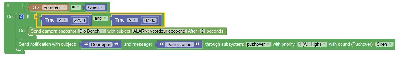

i'am not really handy with Blockly (yet) and i hope maybe u can help me with a blockly script
But it dus not work ?, or better it works to good. becourse i dussent matter when i open the door i wil allways get a push message and e-mail
what am I doing wrong ?
Tnx
-A

First of all you don't need to use two IF statements.
IF voordeur = Open AND Time > 22:30 AND Time < 07:00
To prevent Domoticz sending repeating messages, with blockly you must use a user variable. Make one and call it "Door" using "Open" and "Closed" like string.

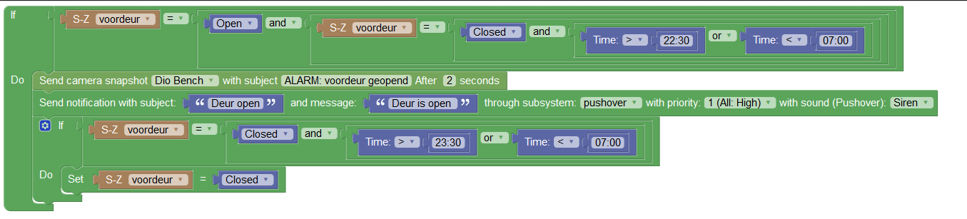

he Guy's
firt tnx for the time to think this over, is this what you mean ?.
it seem to me a bit overdone ?, but oke iám een noob in Blockly

I have never successfully nested "If" blocks. I don't think that will work. Try re-writing as per @Denny64 above using a single "If - Else If".
Have a look at some blockly examples on the forum. You will see how to structure the blocks. Although it has its limitations I have around 40 blockly scripts running successfully for years now. You will soon get the hang of it.

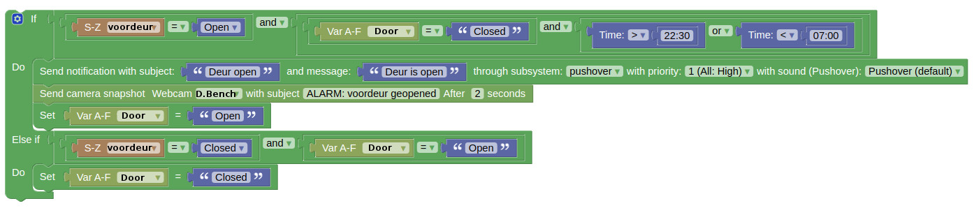

This is the right blockly to avoid recursive message:
Schermata a 2018-06-16 15-21-53.jpg (107.37 KiB) Viewed 2616 times
Don't forget to create a user variable called "Door".

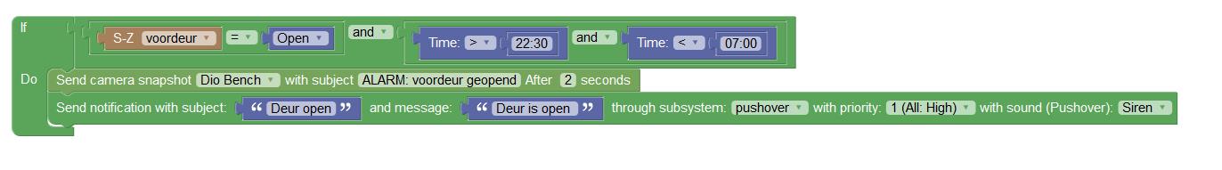

i really dont understand it anymore,
i made:
so i tested it yesterday, change the first time to 17:30 open the door and yes i get a push message and e-mail .
so i change the time back to 22:30 and open the door again, yes no message so the time is working, so far so fine .....
at 22:30 i open the door YES again a message zo the time settings are really working (so I thought) ... next morning on 07:00 i open the door.
and again a push message and a email. I thought ok so thats working.... but today on 12:00 a clock my girlfriend get home opens the door.
and i get a message huh ?..... why thats not posible ...
so i really dont know it anymore, i made about 10 differents blockly setups and everytime as I thought yes thats the right one its not.
what i'am doing wrong ?.

Hi TheCub3,
your blockly is wrong.
use < instead of >
Kind regards
Cobra045

hi all,
Just dit a test, but still the same issue Blockly is now:
and i opened the door at 19:17 and i got a push message and a e-mail, i dont know why but i cant get the time settings working.
what i'am i doing wrong, i dont know it anymore.

Try simplifying your blockly. The “if else/if” block without an else/if usualy doesn’t work. And the second “and” won’t work, because time cannot be “> 22:30 AND < 08:00”. Create a blockly for the first period (>22:30 and <23:59), then create a second blockly for the second period (>00:00 and <08:00).

tnx i wil try that, i just made
and this works indeed, i wil made a second one voor the night tnx i wil let you know if this works
