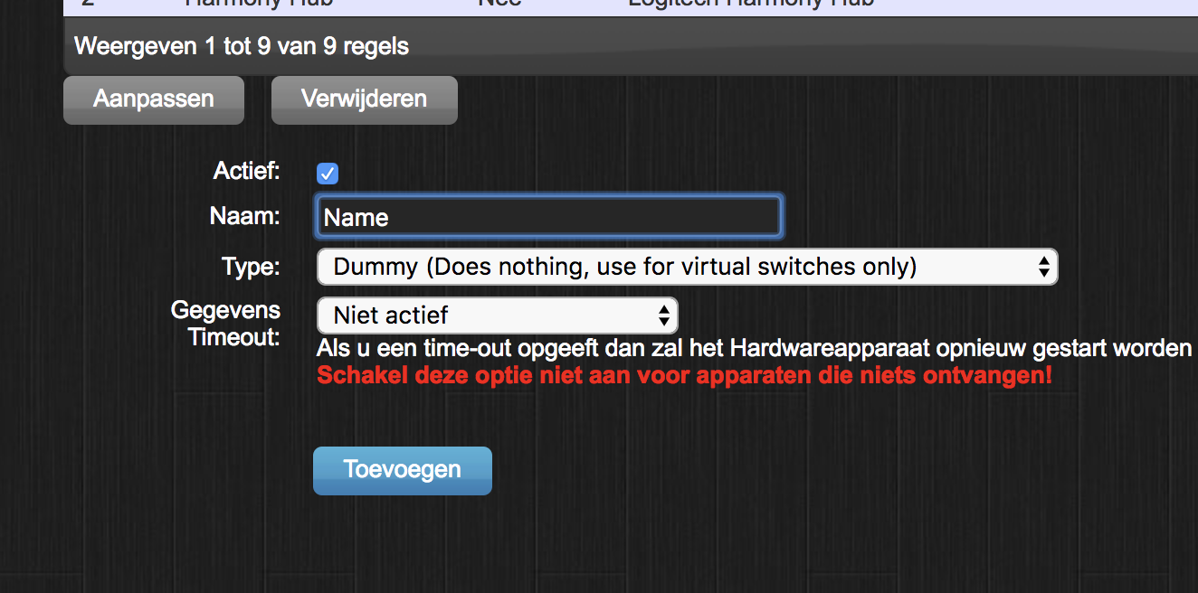

Under Hardware, first add the Dummy (under the list of already available hardware), then when added, you can add dummy devices
Schermafbeelding 2018-06-06 om 17.33.18.png (348.69 KiB) Viewed 2909 times
