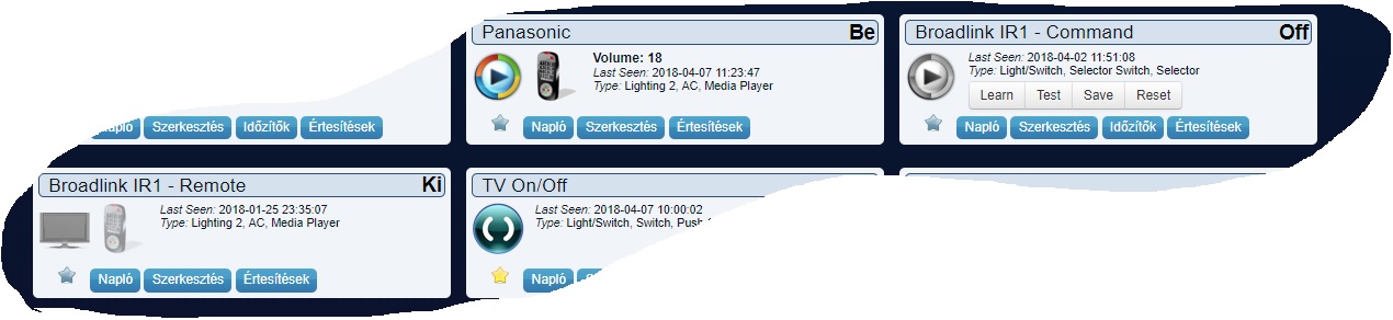

I operate plugin under windows since few months without any problem.
Now i am trying to transfer domoticz system onto small pc running ubuntu 16.04 LTS server on it.
Everything is fine except Broadlink plugin.
Seems, no error on boot, i can select "Broadlink with Kodi remote" as a hardware, but that is it.
No device/switch connects to Broadlink.
Under windows i have 2 switches; "Broadlink - command", that allows me to learn/test/save/reset ir commands with simple buttons and "Broadlink - remote", probably for Kodi.
After learn and save an Ir command, i have a new *.ini file in specific folder and i have a new device with the new ini file under device menu.
If i just simply add this device to a system as for example a dummy push button, it is ready to use.
Shouild i have same things above under linux as well? Or woking different way? Sould i have to define learn/test/save/reset as scripts for dummy switch/button?
Thanks in advance.
