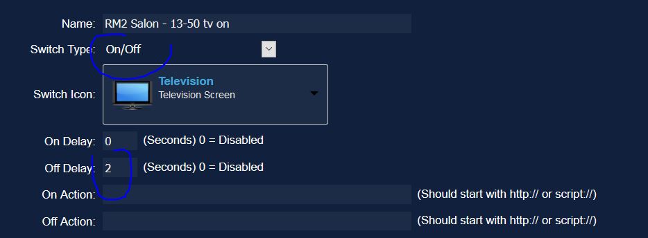

Zak, another question if possible:
when I make IR command for example for my Panasonic TV -
before (V3) I could choose TV Icon
now (V4) only default Round On/OFF is present
Can I make logical switch On/OFF for Broadlink IR ini with TV pic ?
zak45
- Posts: 954
- Joined: Sunday 22 January 2017 11:37
- Target OS: Windows
- Domoticz version: V2024.4
Re: Python Plugin : Broadlink RM2 V4
should work in this way :Velly wrote: Saturday 27 January 2018 18:05 Zak, another question if possible:
Velly
- Posts: 20
- Joined: Sunday 22 October 2017 19:56
GREAT !!!
I could never guess about off delay...
Thank you man!
Thank you man!

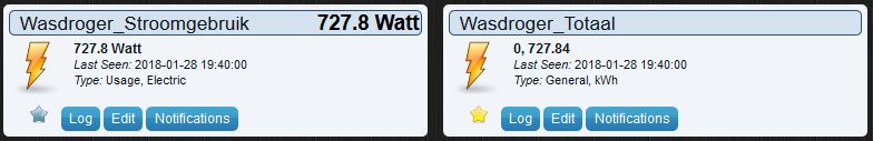

I installed this plugin for my Smartsocket with power indicator, but I cannot get the power information:
2018-01-28 14:44:32.736 (Broadlink Smart Outlet) Calling message handler 'onHeartbeat'.
2018-01-28 14:44:32.737 (Broadlink Smart Outlet) SP3S called
2018-01-28 14:44:32.848 Error: (Broadlink Smart Outlet) Get Energy error
2018-01-28 14:44:32.885 (Broadlink Smart Outlet) Power state : True
2018-01-28 14:44:32.886 (Broadlink Smart Outlet - SP3S) Updating device from 0:'Off' to have values 1:'On'.
2018-01-28 14:44:32.894 (Broadlink Smart Outlet) Update 1:'On' (Broadlink Smart Outlet - SP3S)
What can be wrong here?
Hesmink
- Posts: 168
- Joined: Monday 22 June 2015 10:48
Found the issue to be an incompatibility of python3 with ord, as described here:Hesmink wrote: Sunday 28 January 2018 14:47 Hello,

Yep.. you can found the corrected version in dropBox : python-broadlink-master-0.6.zipHesmink wrote: Sunday 28 January 2018 16:14

Another question, why use 2 status blocks for power and usage?
I'd prefer it to be one, like:
Now it looks like:
Now it looks like:
