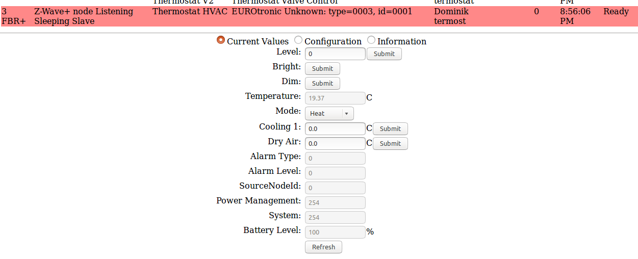

I am new to domoticz and Z-wave in general but I have decided to give it a try.
I have one StellaZ configured already and I have just purchased Sprint (eurotronic).
It seems to be recognized but apparently there is no possibility to set a set-point.
In additional when I compare specification to what I can see in domoticz it is quite messy.
Setup:
domoticz: 3.8153
controller: Aeotec Z-stick Gen5
Thermostat: Sprint z-wave plus (eurotronic)
Setup:
domoticz: 3.8153
- how it looks in control panel. Set-points (when set) are going back to "0"
- Screenshot-2017-10-13 OpenZWave Control Panel.png (54.75 KiB) Viewed 6297 times

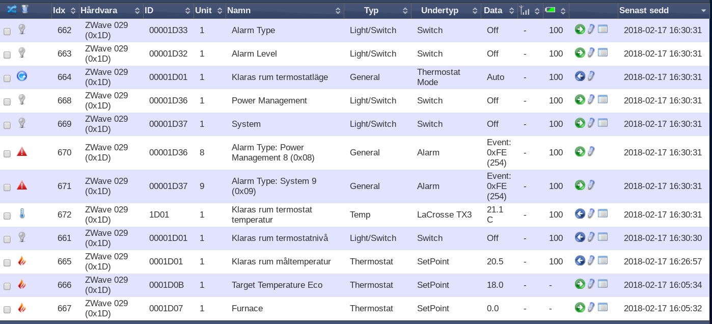

I now have tree of these thermostats. I took the latest device xml from the OZW github pull request and it almost works. I'm on the latest beta (3.8922).
The problem is that the temperature and valve position are not updated automatically even if I have set it up like that. I get values if I update manually in the OZW control panel or if I enable polling.
I also don't know what the "Furnace" set point is...
Any ideas?
Device file:
https://github.com/tobiasgraf/open-zwav ... piritz.xml
/Mattias
Any ideas?
Device file:
/Mattias

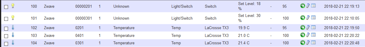

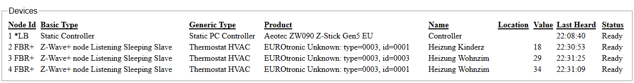

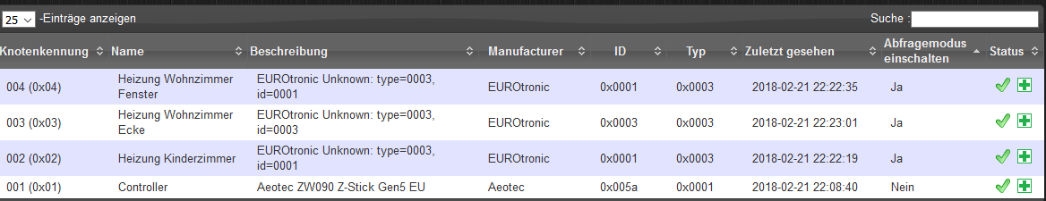

manufacturer_specific.xml
<Product type="0003" id="0001" name="EUR_SPIRITZ Wall Radiator Thermostat Valve Control" config="eurotronic/eur_spiritz.xml"/>
<Product type="0003" id="0003" name="EUR_SPIRITZ Wall Radiator Thermostat Valve Control" config="eurotronic/eur_spiritz.xml"/>
Is it enough to delete the thermostats on Device?
Do the thermostats also have to be deleted for hardware under ZWAVE?
But I miss Light/Switch for 401
Temperature 401 is present.
201 and 301 temperature and light/switch available
- Unbenannt2.png (23.57 KiB) Viewed 4820 times
