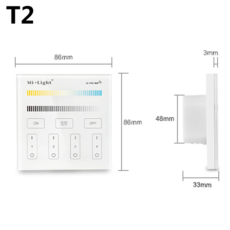

- t2-switch.jpg (120.09 KiB) Viewed 1943 times
