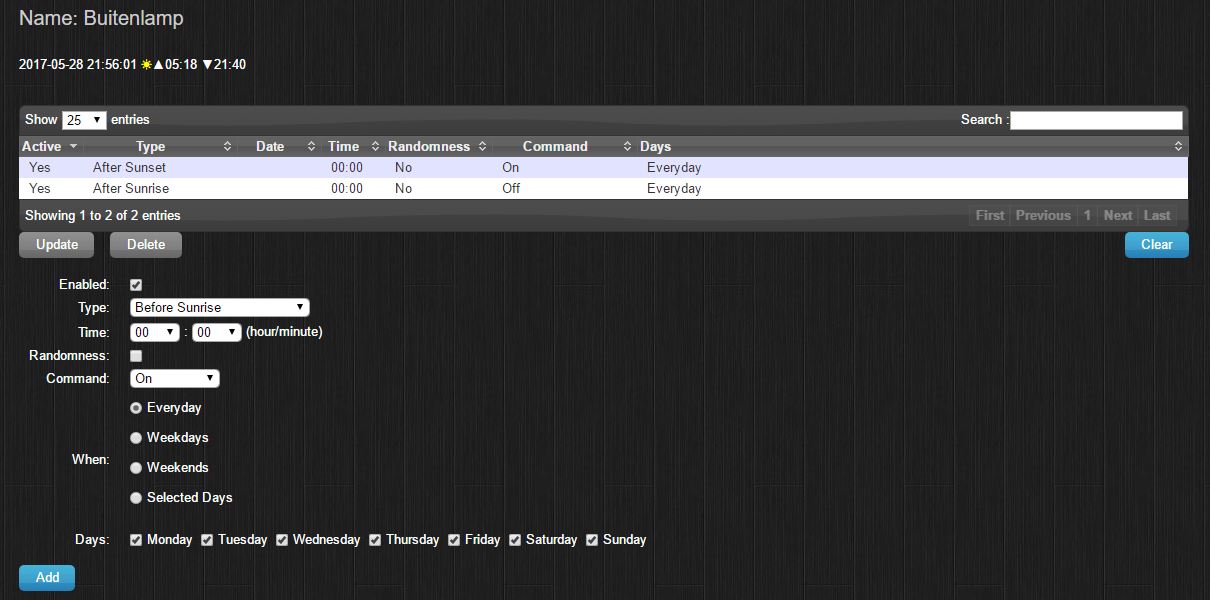

I'm new here. Just started Domoticz on Pi3 with RFXtrx433E. Yesterday I started a simpel test. Lamps on at 20 min before sunset and turn off at the fixed time 23:30.
Lamp go on on time but won't go off. After experimenting with the fixed times it looks like it's not working most of the times.
Anyone else with this problem?
Manuall on/off works all the time.
Hope to hear from you.

Have a look in the logfile, do you see the "off" command there?

In the log file it sometimes says off while it schould be on at that time.

Seems that the problem only occurs with the 'on time' function.

That could be an issue, but if I turn them on and off manually with Domoticz they always turn on and off. They always respond at the first klick. Also with the original KAKU remote.
