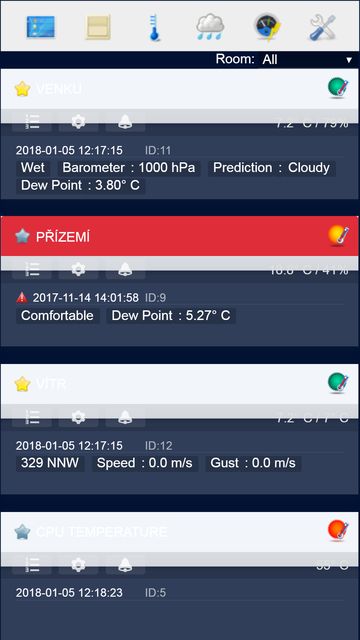

I have exactly the same issue on Chrome on my 2 PCs, my iPhone & iPad via Safari. all cleared cache as welljeanclic wrote: Friday 05 January 2018 9:23 Hello,
I have troubles displaying the latest version on Firefox (did not tried on any other browser):
Does anyone encounters the same issue ? (I cleaned cache and deleted datas as always).
EDIT: I tried to go in the parameters and click on "apply parameters" without changing anything:
EDIT2: I tried it on Chrome too: same result. Maybe this is because I completely removed the aurora folder and replaced it with the one just downloaded from this topic ?

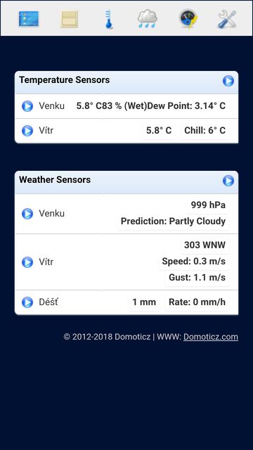

But I have similar problem at mobile phone. Android 7, Chrome 63.0.3239.111 - appcache cleared
Edit: Red color is OK, I know, that sensors are offline, but....
Edit2: Same problem at Desktop Chrome switched to mobile view

What happens if you open another page and return back to dashboard. It looks like the issue I had before.

No change:eenernl wrote: Friday 05 January 2018 11:59What happens if you open another page and return back to dashboard. It looks like the issue I had before.

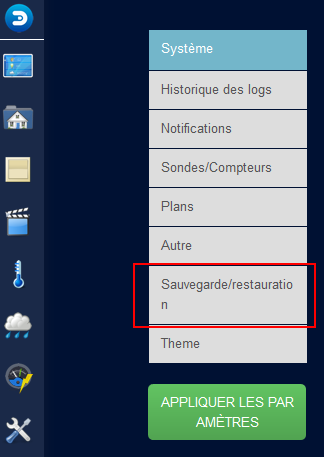

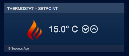

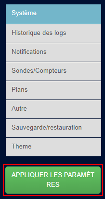

Hello blauwebuis,
very nice work, I think I am about to use the Aurora Theme in production today !
there is still a minor issue with parameters menu: The Thermostat new feature is very good, even if it is not working very fast.

After putting theme on my wall tablett, I have 2 issues:
1 - see screenshot : tiles are not good for highlighted items: 2 - On my wall tablett I have a user beeing only "user". and I have to set the theme as I want (no Iphone styling) with primary user before beeing able to use it with my second user. (so I deduce that the settings I have put on my computer are not taken into account on an other one. I find this not good for me... sorry if I am not very clear.
PS : barometer is working, but it takes a few minutes to show.
PS2 : I assume you are aware that on firefox or chrome, there is a mode to test different tabletts/phones resolutions ? (CTRL+SHIFT+M) on firefox dev tool.
