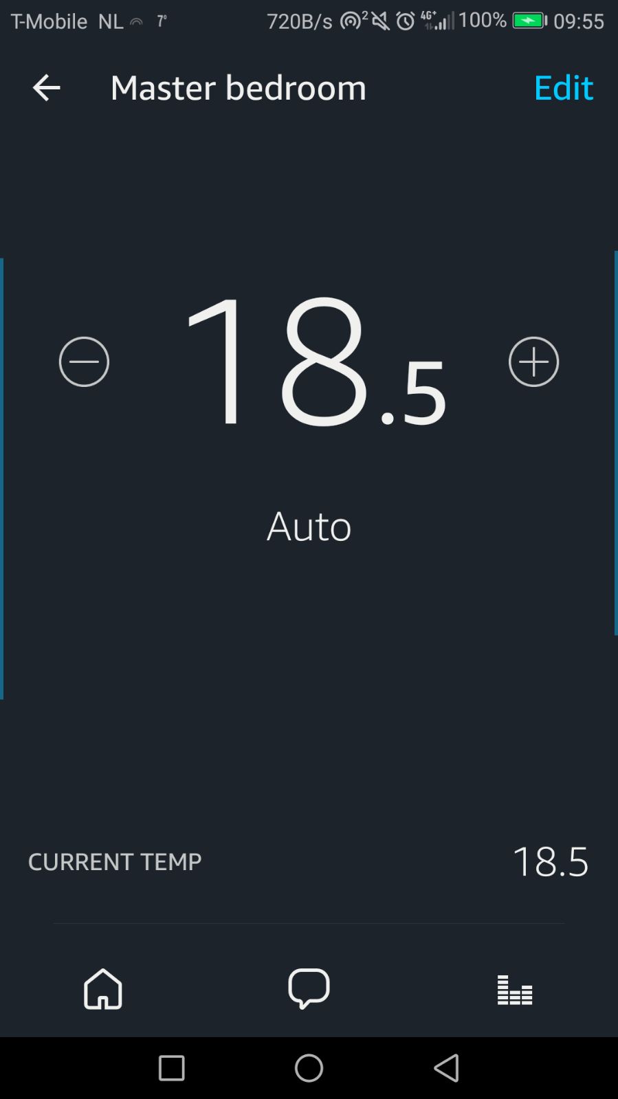

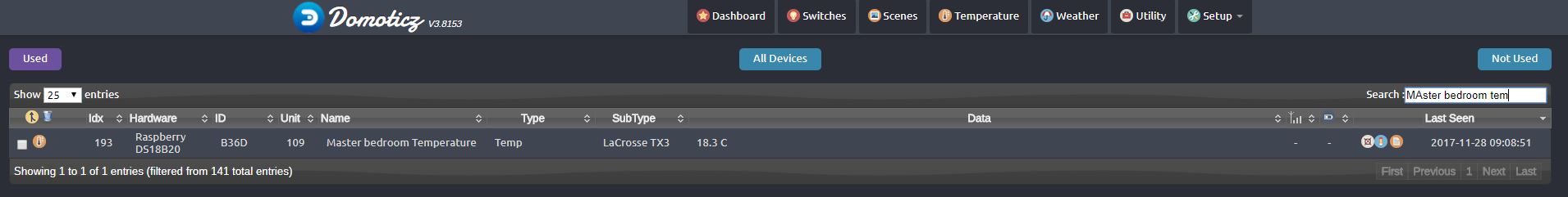

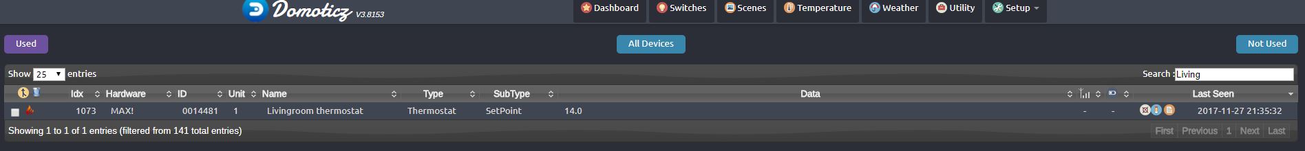

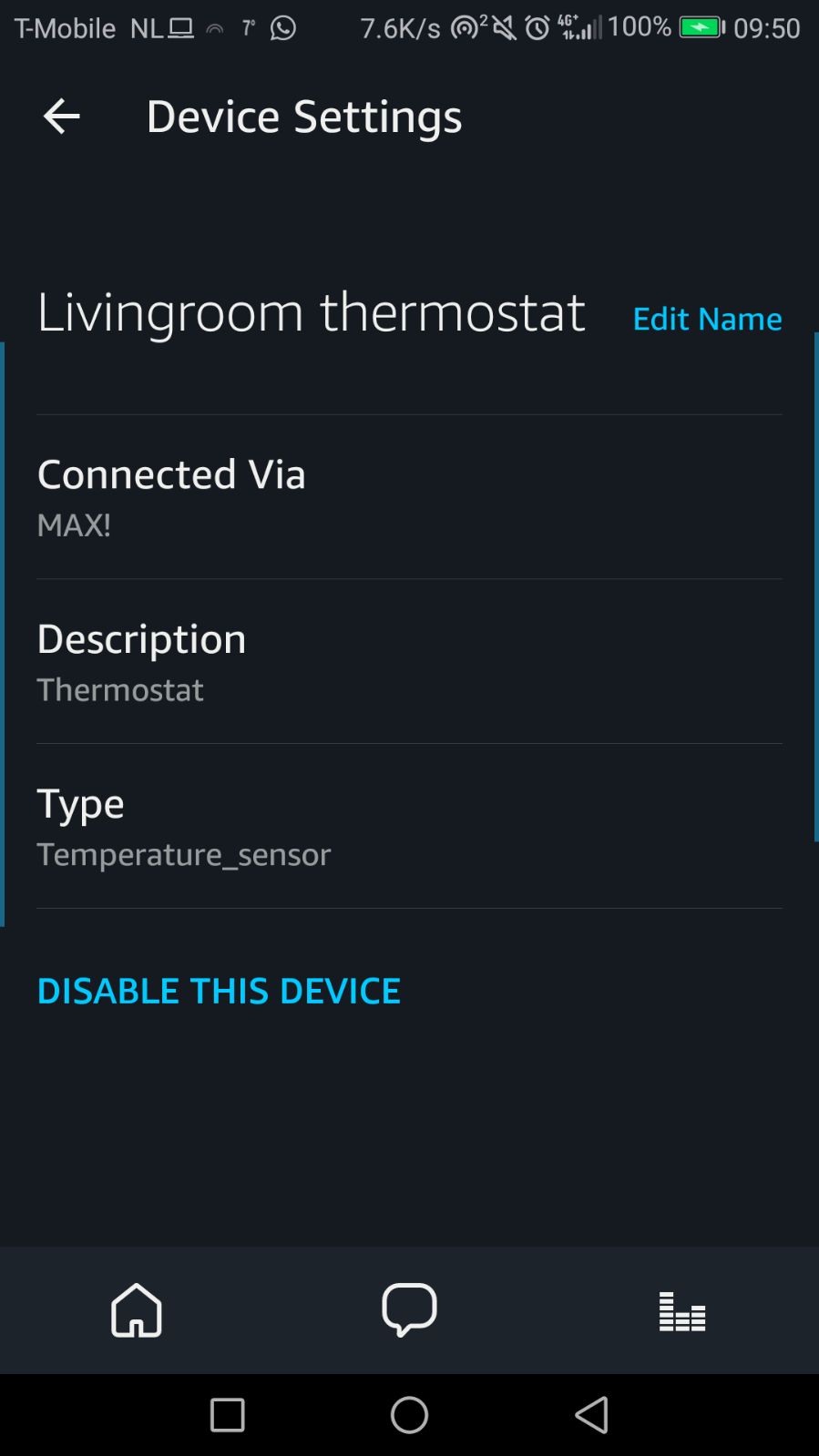

Hi Madgeni,
Thank you for the awesome work.
After hours of struggling with the installation and many search in this topic, i finally got it working. May be a step by step guide in the Controlicz webpage?
Alexa has discovered my devices succesfully. However Alexa included my devices in a uncorrect type device.
My thermostat is now recognize as a temperature sensor and I can not tell Alexa to set my thermostat to ... degree. She responsed with The devcie does not support that
My temperature sensor is now recognize as thermostat and I can not ask Alexa regarding the temperature.
Do you know how I can fix this?

Chakkie
Posts: 33
Joined: Wednesday 23 December 2015 11:27
Re: Controlicz - Easy Domoticz to Alexa Integration
Post by Chakkie »
Thank you. Please do not apologize. You have done a great job to provide Domoticz users a great integration with Alexa.
I have just remove all the domoticz devices (Use 'Forget') and re run the discovery. Still the temperature sensor is recognized as a thermostat type.
I am not home so I can not test the request "what's the temperature in <devicename>?" but I think the problem is still exist. I will PM you the number of both devices
Alexa recognizes temperature sensor as thermostat
