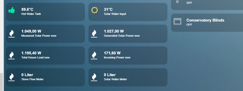

** SOLVED **
morning guys,
I've just started on my Dashticz odyssey and I'm doing OK after a few false starts.
I've hit an issue that has me stumped at the moment relating to dummy devices.
I want to do my 'notifications' by manipulating the icon rather than changing the background or similar.
Using the blocks[532]['icon'] = 'fa-sun-o'; works fine generally and I can then insert code into custom.js to change the icon/colour/etc as the data changes. All great!
However, I have some bespoke items relating to power that do not want to take a new icon and I can't make the change in custom.js either.
I'm guessing this may be down to the nature of the item.
They all currently show a flame (Gas?) as the icon and I can't seem to make any changes.
They are either,
SMA Spot install (WIKI - http://www.domoticz.com/wiki/SMASpot_Mo ... n_Domoticz)
MySensors Power clamp set up
Dummy item which is an output from data above. E.g. House Load (from MySensors) minus the SMA solar to give me a total power requirement.

Any idea what I'm doing wrong or am I out of luck?
Reading back through the thread (sooo long, my eyes hurt :D ) it looks like these items may not be coded for and default to the Gas block?
Thoughts and advice most welcome!
Kevin
Edit running gitpull from two days ago.

You might need to specify the icons for the blocks with an underscore, for example:
blocks['35_1'] = {'icon': 'fa-sun-o'};
The power devices usually have multiple blocks per idx and I think the icon is only checked per sub-block.

Bang on the money - thanks.
I'd tried blocks[35_1] = {'icon': 'fa-sun-o'}; which crashed the screen.
Adding the ' around the 35_1 makes the difference.
So simple....
Excellent!
