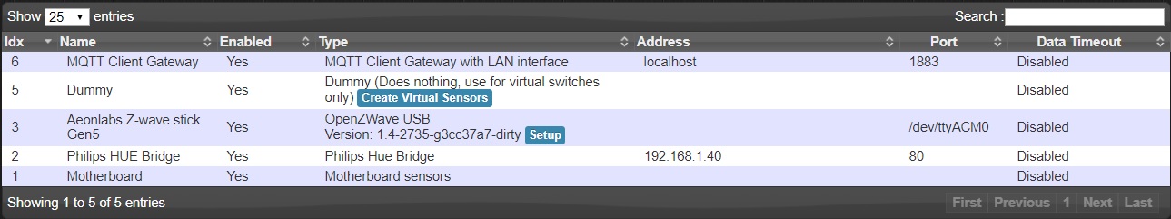

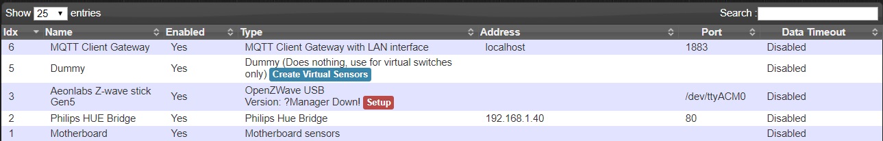

@Jumbotroll
i have been running domoticz 81.53 for some time now on my DS718+ with latest DSM 6.1.3-15152 Update 7
I have however experienced a recurring problem which has occured 2 times now.
From time to time i loose the complete connectivity to my z wave devices(zwave plus gen5 stick)
the complete config seems gone when i enter the zwave setup
the only thing to get things working is
setup-hardware:select zwave stick and deselect enabled Press update
usb down.jpg (77.78 KiB) Viewed 3738 times
after that select zwave stick again and SELECT enabled Press update
usb up.jpg (90.53 KiB) Viewed 3738 times
after that everything is working again(when you go to zwave setup every device is there again)
it looks like a disruption problem with the usb driver
does this sound familiar? eg is there a solution
i never had this problem with the DS112+, also with dsm6 running
jumbotroll
Posts: 793
Joined: Tuesday 13 January 2015 14:36
Location: Oslo,Norway
Re: domoticz in synology as package! Available now.
Post by jumbotroll »
@Gravityz
Sorry, never seen this problem before..
If you use USB Hub, try without or you can try to change the USB port for your Zwave Gen5 device.
If you like the work I do for synology and domoticz, I appreciate a donation.
https://paypal.me/Jumbotroll
Jumbotroll
http://www.jadahl.com
Gravityz
Posts: 652
Domoticz version: 2025.1
Post by Gravityz »
Ok.
Could it be that connecting with winscp or putty to the synology can cause a disruption to the serial usb port.
I have read that another user had this problem
I connect with ssh and after that with Putty.
Maybe it interferes with the /dev/ttyACM0 driver
