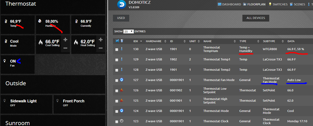

A couple of things I've noticed with some of the thermostat blocks...
- The Temp+Hum sensor blocks will not resize. The screenshot shows the Thermostat column set to 12 wide. Though set to 6 (or other number) these blocks only display as the default 4 wide.
- Temp+Hum blocks show a comma instead of a decimal in values (66,9F vs 66.9F) even though the sensor values show decimals. The "single temp" sensor block (IDX 129) show the decimal as reported.
- The "Low Setpoint" block (IDX 126) will only accept pressing the "-" button to lower the temp. The "+" doesn't work, so as I'm testing all of this it's getting colder and colder in here :)
- The Fan Mode block doesn't show the sensor value (IDX 127) and instead just shows "On". The block acts like an on/off switch and flashes "Off" when I click it, but the value remains "On".
/* Thermostat start */
blocks['blocktitle_thermostat'] = {}
blocks['blocktitle_thermostat']['type'] = 'blocktitle';
blocks['blocktitle_thermostat']['title'] = 'Thermostat';
blocks[129] = {}
blocks[129]['title'] = 'Currently';
//blocks[129]['width'] = 5;
blocks['130_1'] = {}
blocks['130_1']['title'] = 'Temp';
blocks['130_1']['width'] = 6;
blocks['130_2'] = {}
blocks['130_2']['title'] = 'Humidity';
blocks['130_2']['width'] = 6;
blocks[126] = {}
blocks[126]['title'] = 'Cool Setting';
//blocks[126]['width'] = 5;
blocks[125] = {}
blocks[125]['title'] = 'Heat Setting';
//blocks[125]['width'] = 5;
blocks[124] = {}
blocks[124]['title'] = 'Mode';
//blocks[124]['width'] = 2;
blocks[127] = {}
blocks[127]['title'] = 'Fan';
blocks[127]['switch'] = true;
//blocks[127]['width'] = 2;
/* Thermostat end */

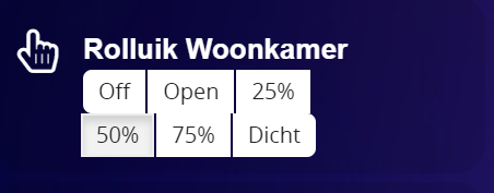

Issue with Selector Switch.
In Domoticz there is the option to "hide off level". I use this option, but in Dashticz it's still showing.
Domoticz "Hide Off Level"
Dashticz still showing the "Off Level"
         "AddjMulti" : 1.0,
         "AddjMulti2" : 1.0,
         "AddjValue" : 0.0,
         "AddjValue2" : 0.0,
         "BatteryLevel" : 255,
         "CustomImage" : 102,
         "Data" : "Set Level: 30 %",
         "Description" : "",
         "Favorite" : 1,
         "HardwareID" : 7,
         "HardwareName" : "Dummy Virtual Switch",
         "HardwareType" : "Dummy (Does nothing, use for virtual switches only)",
         "HardwareTypeVal" : 15,
         "HaveDimmer" : true,
         "HaveGroupCmd" : true,
         "HaveTimeout" : false,
         "ID" : "00014132",
         "Image" : "Rolluik",
         "IsSubDevice" : false,
         "LastUpdate" : "2017-10-21 12:02:59",
         "Level" : 30,
         "LevelActions" :,
         "LevelInt" : 30,
         "LevelNames" : "Off|Open|25%|50%|75%|Dicht",
         "LevelOffHidden" : true,
         "MaxDimLevel" : 100,
         "Name" : "Rolluik Woonkamer [Selector]",
         "Notifications" : "false",
         "PlanID" : "2",
         "PlanIDs" : [ 2 ],
         "Protected" : false,
         "SelectorStyle" : 0,
         "ShowNotifications" : true,
         "SignalLevel" : "-",
         "Status" : "Set Level: 30 %",
         "StrParam1" : "",
         "StrParam2" : "",
         "SubType" : "Selector Switch",
         "SwitchType" : "Selector",
         "SwitchTypeVal" : 18,
         "Timers" : "false",
         "Type" : "Light/Switch",
         "TypeImg" : "Light",
         "Unit" : 1,
         "Used" : 1,
         "UsedByCamera" : false,
         "XOffset" : "0",
         "YOffset" : "0",
         "idx" : "226"
Hardware:
EdwinK
Posts: 1820
Location: Rhoon
Re: Dashticz - Bug report
Post by EdwinK »
Try this:
Screen Shot 2017-10-25 at 15.43.34.png (13.97 KiB) Viewed 5667 times
(hide off-switch) It's on the settings-page (see clogwheel)
Or use this in CONFIG.js
config['hide_off_button'] = 1;
htilburgs
Posts: 464
Post by htilburgs »
:oops: :shock:
I thought I knew all the settings by now, but not.... (feeling a littlebit ashamed)...
Thanks Edwin, that does the trick!
