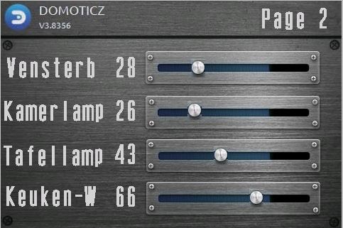

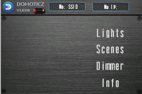

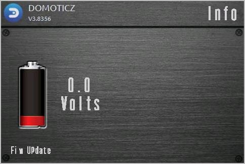

been tinkering around with my esp8266 and nextion display and came up with this

Re: Domotics touchscreen remote
Yep sure are
for anybody that's wants it just contact me
new version has had a lot of updates both in the code as in the gui
Latest version is here
now has a couple of new options
-ftp server onboard for uploading config files
-config can be changed via build in webserver
-battery status is reported back to domoticz.
-voice updates are possible now via the remote hw info will folow
-battery last atleast a full day with a 2600 mAh Lipo
https://github.com/ledfreak3d/Domoticz-remote-
