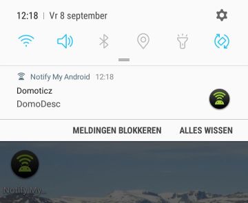

And a little later this "popupped" on my phone:
But I cannot get it to work in Domoticz. The testbutton in Domoticz result in (the log):
