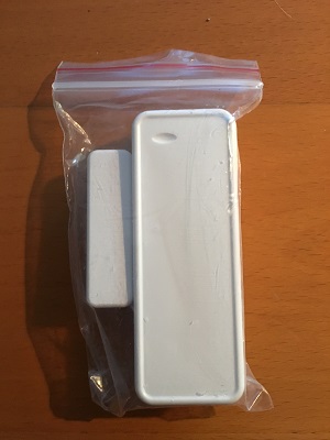

So I don't know if this is special or not but I found these cheap Door sensor that look great, are really cheap (<€ 5,-) and send an open and close signal.
https://www.aliexpress.com/item/433MHz- ... 91010.html
I thought I would share how to set them up in Domoticz.

Post by bassie127 »
JelteV wrote: Sunday 03 September 2017 20:12 Hi,
To know the state of the door we need to add 2 small scripts.
One when the door is opened and one when closed.
Here they are:
