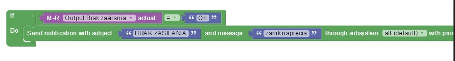

I am trying to configure notifications via Pushover for alarm events.
I can only configure notifications for 'Current state' values, not for 'sValues'. What's the difference?
Why there is no 'current state' for few outputs?
How to handle it?
How to handle it?
- domoticz.jpg (26.08 KiB) Viewed 2440 times
- domoticz.jpg (208.48 KiB) Viewed 2444 times
petecz
- Posts: 5
- Joined: Sunday 13 August 2017 17:53
Re: sValues vs Current state - Satel Integra
Or I need other ideas for configuring notifications.... Only 'Arm partition' works at the moment.
Why 'text device' hasn't any current state, how to rewrite it from sValue?
